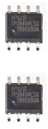

I already have a couple Teensy 4.1's but wanted a super-sized one as a developer base unit for my bench. I found one on Amazon that includes an ethernet kit and 2 PSRAM chips - ips6404lsq 1806x8gn that supposedly add 16mb of PSRAM to the board. I would prefer octal, and these are quad, but Mouser shows them as 8 bits wide. I thought QUAD PSRAM was nibbles in width so it is a bit confusing.
I haven't dug into the PSRAM addressing of the Teensy 4.1 board yet, so have little understanding of how the added PSRAM will be addressed.
Is this something I should go after? If not, are there better options for added PSRAM?

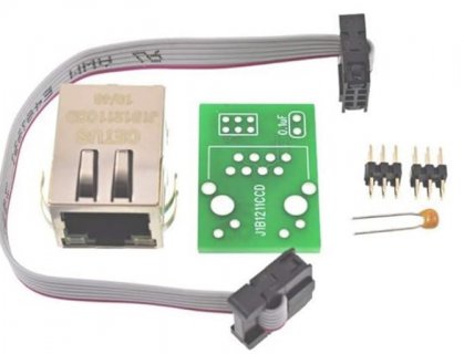

The Ethernet kit seems to just include an ethernet port, a couple of headers, and a cable. Is that really all I need to connect this beast of a dev board to my home network?? I thought it was more involved than that.

Yes, that is one of the 4 chips that have been tested and are known to work. In fact, that picture looks like someone just copied the photo from the PJRC website.
Yes, that simple kit is all you need to connect ethernet. Teensy 4.1 has an ethernet PHY chip (the analog part of ethernet) and the ethernet mac (digital part) is built inside the main processor.
Ignore the basic summary info on Mouser's website. Info in the ApMemory datasheet and on the PJRC website is reliable.
Thanks for the link thebigg and the info Paul, I appreciate it.
That image has to be the same as the PJRC site. Dust or whatever markings on one of the pins matches. Honestly, if you sell something on Amazon, how hard is it to take an actual picture of the actual product before posting it? I will be checking those closely when they show up and I am glad you said something. I am sure that happens all the time too.
