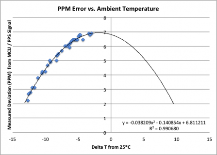

Done. Now calculating what RTC PPM should be at 25*C
Over a 10 second interval, the MCU took 10000155 'MCU micro-seconds'.
Over a 10 second interval, the RTC took 10000087 'MCU micro-seconds'.
i.e. 15.50PPM for the MCU and 8.70PPM for the RTC, i.e. a 6.80PPM difference.

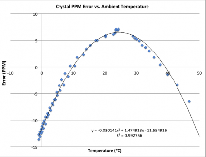

It is 22.44 *C on board, which suggests a 0.04 PPM correction per the crystal spec. sheet.
So, at 25*C, the crystal correction factor should be: 6.76 PPM
Over a 18 second interval, the MCU took 18000279 'MCU micro-seconds'.
Over a 18 second interval, the RTC took 18000279 'MCU micro-seconds'.
i.e. 15.50PPM for the MCU and 15.50PPM for the RTC, i.e. a 0.00PPM difference
Not that the code is always this close but it's usually to within less than 0.1PPM. I do get the odd malfunction and the initial offset calculation is garbage. I'll re-write that section to detect odd output and repeat the measurements.
The advantage of storing the crystal error at 25*C is that you can then easily compensate for ambient temperatures later. Now is this approach 100% accurate? Of course not. The inversion point for crystals may vary from 20-30*C. So without further testing, there is no way of knowing whether 25*C is the actual inversion point. It may be practical enough to apply the ambient temperature correction factor once a minute and still end up with a device whose accuracy exceeds 1PPM.
The only downside to this approach (vs. using a TXO RTC) is that the TXO RTC will do all this work for you, whether the MCU is running and/or paying attention to it, or not. The above crystal approach requires the MCU to be powered 100% of the time and to be able to make periodic adjustments. Additionally, in order to discover the initial calibration factor, some testing is required. A TXO RTC like the DS3231 will save you all that work but will take up more board space and require two I2C lines to communicate with your MCU.

Had some fun today and logged a whole lot of data points while the board and the crystal were adjusting to outdoor temperatures and back again.
As you can see, the data describes the parabola that is expected. The formula is totally different from what I expected per the specifications, but that's not a particular worry, as the data also nicely shows where the turnover temperature is for the crystal. So, this correction factor is arguably better since it captures the parabola data better.
The next step was implementing a least-squares approach to calculating the factors for the 2nd power approximation. Via MS Excel, I also confirmed that the resulting factors are correct. My next task is burning the factors into the EEPROM, preferably as floats. However, I am failing in this regard as the EEPROMEx library I'd like to be using will not compile on the Teensy 3 (works just fine on AVRs…).
