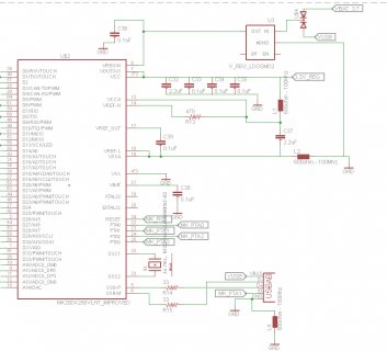

Dear Paul,
First of all thank you for answering my post. I want to be clear that I am in no way trying to replicate the teensy itself, on the contrary, I bought 4 teensy's and I have been prototyping with them, but now that I want to go to a custom product, includying the teensy itself in to my design will be a size issue, so that is why I am going for using the MK20 and the MINI54 on a custom design.

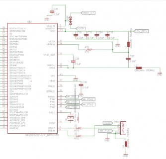

Attached you can see what I meant about the diodes. The idea is to use the 1A diodes to allow the input of the internal regulator of the MK20 to receive VBAT 3.7, but to switch to VUSB functioning when it is available. It would be something like the schematic you have on the web page, but moving the part you suggest to cut for battery powered teensy to the wire that connects the anodes of the 1A diodes, and actually cutting it. The first image I attach shows how I mean this.
A second concern I had when using a 3.7V Battery, is that the MK20 datasheet says that the internal regulator only guarantees 3.3V output for VREGIN > 3.6, which means the 3.3V output wont be stable any more when my battery is just a bit lower (3.6V or 3.5V). Considering this I have been thinking to include an external regulator as shown in my second image, so that I can guarantee 3.3V when the input ranges from 3.3V to 3.7V. Do you have any comments on this? Is it better to use the external regulator than the internal one due to this specification I mention? I also include a screenshot of the Datasheet saying that below 3.6V the output would not be mantained and it enters in "pass through mode".

The diode approach seems fine.
Yes, an external regulator with lower dropout spec will allow running longer with the 3.3V power in full regulation.
The USB is specified to work down to 3.0 volts, and in testing it usually performs well down to 2.7 and often to about 2.5. While that's out of spec, it still usually works fine, so maybe that's an acceptable trade-off for the last several percent of the battery's charge? The extra LDO regulator with lower dropout spec would be the more proper way, of course.
You might also want to consider a way to monitor the battery voltage, or estimate the remaining charge, so you can shut down to avoid deep discharge of the battery.
