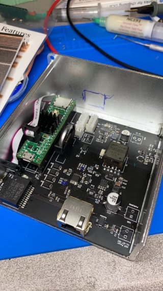

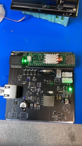

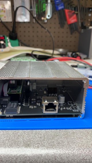

In any event to prevent further damage and to hold the manufacture accountable I built the following device to monitor Humidity and Temp and log the data to a remote SQL Server so i could generate a report and prove that i never fell below the RHT Limit. I also wanted to see how the RHT fluctuated throughout the day so i could turn on Humidifiers and monitor the results
This Board i built is POE Powered.

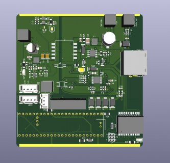

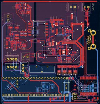

I designed the board in KICAD and had it manufactured by JLCPCB.
