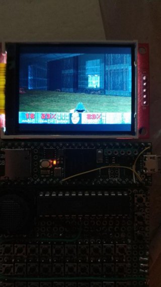

I just tried and the latest code published is working with the ILI for me.
You can try reducing the SPI clock in tft_t_dma.cpp
#define SPICLOCK 60000000
you can try 40000000?
May be some displays are more tolerant.
I used below config.
The DMA starts in the ino file at tft.startDMA();
You can try to put a delay for debugging?

here is a picture

That's it! I've set it to 55000000 and now it works... ... well at least the demo played for 10-20 seconds and then everything turned to black. Could it be that the screen is not getting enough power causing clock issues?
Edit:
Now it seems to keep on running:
https://www.youtube.com/watch?v=9W24pFAv8CY
Thanks for the help. It is really cool to see Doom run on a Teensy :-D
