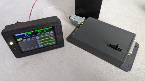

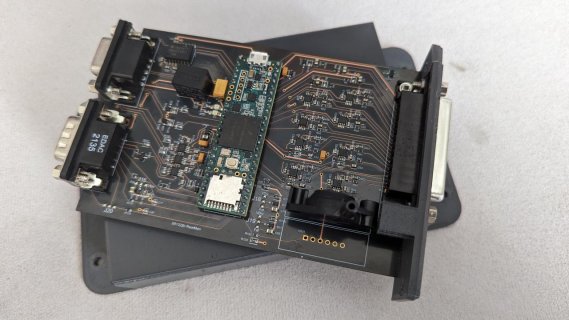

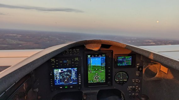

I'm a pilot of an Experimental aircraft and needed a good engine monitor - around 6 or 7 years ago I started with an Arduino and a 2.8" display and a 8 channel thermocouple board... Struggled along, slow screen updates, integer math, etc... Then I found paradise when I ran across the Teensy and Paul's (and all of the contributors) INCREDIBLE work here.
Current version has a Teensy 3.6 mounted near the engine with 23 inputs: 8 K type thermocouple, analog pressures and temperatures (Oil Temp, pressure, manifold pressure, engine timing and RPM, etc... and some spares, along with a spare RS232 input. This board communicates via RS232 to the display module.
The display module has a 3.5" cap touch screen, 8 more inputs (2nd RPM, Fuel flow, airspeed and altitude, temperature, volt and ammeter...) 6 outputs (warning lights, dimmer and spare) and 3 RS232 channels to share information with my GPS for fuel estimation at the destination, etc... It also records data to a uSD card, stores a variety of settings in flash, and monitors for any out of limits conditions.
Boards were designed in Upverter and procured through OshPark, housings designed in OnShape and printed on my Prusa Mk3. I did add a Teensy 3.6 and a 4.1 model in Upverter so that is now available if anyone needs it.
I have an engineering degree, but never did board design or EE design until this project, and it flies! Anyone who questions what they can do - give it a try - you'll learn a ton along the way, have a lot of fun, experience frustration when things don't go right (or you swap an Rx and a Tx line - which the engineers I work with on NASA programs do routinely as well), and get to make cool things work! If you're interested in checking out the Upverter designs, drop me a note and I'll get you access. I'm open to suggestions in making the designs better as well.

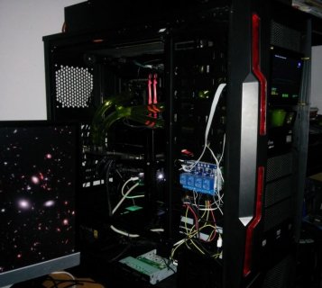

I have a 5" Riverdi BT817 screen installed on the PC on a teensy 4.1 board, to monitor several NTC sensors at different points of the liquid refrigeration. It also allows me to turn the PC on and off from the TFT
Sorry for the mess but I'm finishing the tests with a 4 relay board to control some PWM fans with the teensy 4.1 and the BT817 TFT

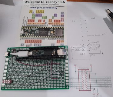

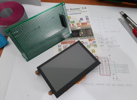

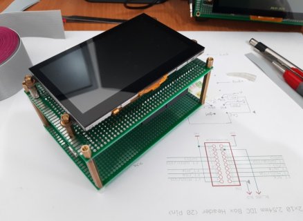

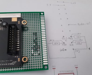

First let's go to the wiring.
I added pullup resistors on the MOSI, MISO and SCK lines to stabilize the signal from the capacitive touch panel. It is activated by the nus SPI and sometimes it is activated only randomly. With these resistors I have not seen that behavior anymore.
I have the same 4.3" capacitive TFT NHD. Since yesterday, I've had the task of connecting it to a teensy 3.6 and being able to share the connection, and of course you can see what it really is. This is how it has been installed.

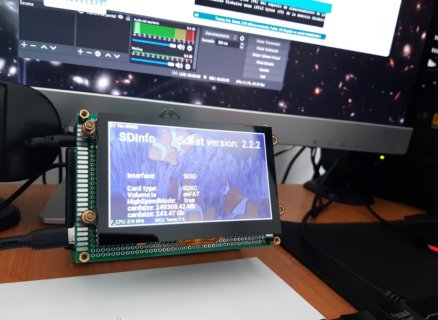

Finally: some functional tests on the first try...

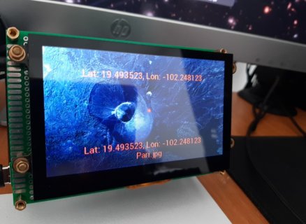

I think you will like this example, it is the base of the GPS that I am building, the complete example of loading JPG maps with GPS positioning is in the library. All you have to do is add the GPS device so that it loads the maps in real time during the journey.
As soon as I have time I'll take it for a drive in the car to take a video and share it.

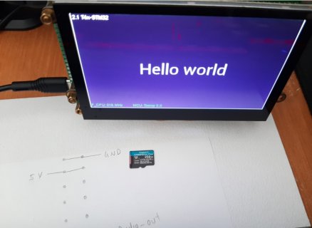

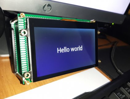

Since you've gotten fully involved with the FTDI-type library, and you already know how it should be used; let me show you the example for "Hello world", using GDSTx
#include <GDSTx.h>
  GD.begin();
  GD.ClearColorRGB(0x100020);
  GD.Clear();
    GD.cmd_text(GD.w / 2, GD.h / 2, 31, OPT_CENTER, "Hello world");
  GD.swap();
To load the image named tree.jpg stored on the microSD, this is the code:

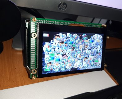

Regarding the handling of images or multimedia files, the version of the library you are using can work with images compressed in a flash memory, but its implementation is somewhat tedious and you must be a very advanced expert in C. The EVE family of chips has a limit on the number of instructions per displayed screen: 2046, when you exceed that limit the screen is corrupted. They may be less depending on the complexity of the instructions or widgets.
On the other hand, when you want to load images you are limited to only 16, as long as you do not exceed the limit of graphics memory. These limits can be resolved by using vertical images in a square cell array for icon handling.
Code: View attachment Icons21.zip
To get around the limits of images that can be used, the GDSTx library is able to use the SDIO reader from the teensy 4.1/3.6 board; Taking advantage of the capabilities of Greiman's most recent SdFat library, we can use exFat-type microSD memories of more than 256 Gb.
Upload the images you want to place on the TFT to see how we can process them. The triangular indicators could be png images, to take advantage of transparency and reduce drawing code.
PD: I moved the TFT rotation 180 degrees to take better care of the TFT flex connector, that's another capability of the screen, you can rotate the content 0, 90, 180 and 270 degrees.

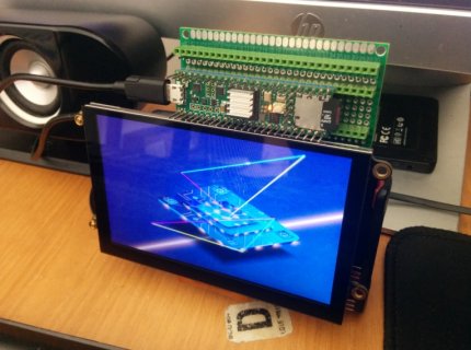

It's alive!
Turns out I think I had a bad jumper wire - of all the things it could have been!
This 800x480 4.3" cap touch display is gorgeous and rocks with the Teensy pushing it. The DPI is fantastically high and the cap touch works really well. NewHaven display
And I can still fit the same display in the panel space I have in the aircraft.
