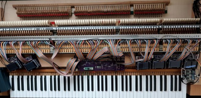

A few years back I started building a hybrid piano with Teensy 4.1 and other components – analog and digital.
Hybrid = acoustic piano action + digital midi controller + other software features. Yamaha and Kawai sell hybrid pianos, but I wanted to build my own.
Recently all 88 piano keys are working, using a Kawai grand piano action.

The project is as much about experimenting as getting anything done. So, I’ve built two different functioning architectures and am working on a third approach. Here is a picture showing both types of boards connected to the piano action:
In the center is my lower performance board (rectangular). If fully populated, it uses two Teensy 4.1 and connects to all 88 keys.
Surrounding it are six of my higher performance boards (square). Each board connects to 8 keys and uses two Teensy 4.1. If I built a complete piano with these boards, it would require 88/8*2 = 22 Teensy 4.1, plus 2 for pedal unit for a total of 24 Teensy 4.1.
