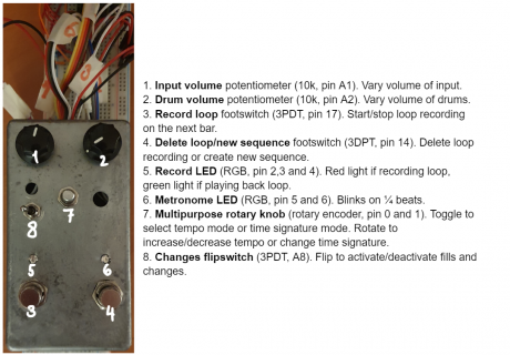

I Forgot to add a picture! Sorry.

If by devices you mean the other pedal in the background, its just an Electro-Harmonix Cathedral Reverb. The guitar runs through it before the loop pedal input, and it is not required, just there to make the sound a bit more interesting. It is possible to have fx on the input both pre and post loop pedal, and it is possible to also have fx on the drums post loop pedal.
The only thing required to build the loop pedal and make it work is:
Teensy 4.0
Audio Adapter Board
SD card (128 mb should be more than enough)
The potentiometers, rotary encoder, LED lights and foot switches can be omitted or handled differently. Right now they just call interrupts in the interactionManager class.
