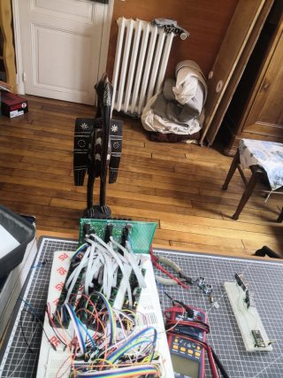

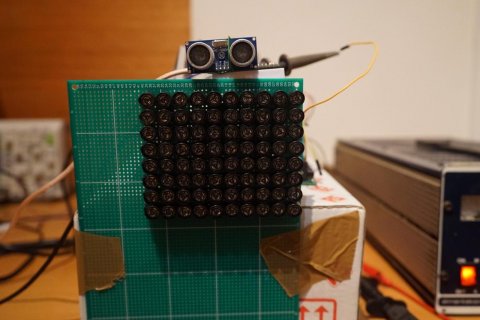

Two years ago I built a fully-functional 3d ultrasonic scanner that used Teensy boards at the edge of their capabilities.
The scanner works by using a Teensy 3.6 to control an array of 80 independent 40khz emitters at a 25Mhz refresh rate to do acoustic beamforming and send a few-degrees-wide acoustic wave.
The sound wave then bounces on the nearest object contained inside the acoustic beam. It is then picked up by an ultrasonic receiver made with a Teensy 3.2 and a hacked HC-SR04 distance sensor.
A PC controls and synchronizes both boards to scan the whole environment of the sensor. It then does the signal processing and the 3d visualization of the sensor's environment.
A few photos:
From the front: emitter array and receiver
From the top: receiver on the left, shift registers + transistors in the middle, Teensy 3.6 and level shifter boards on the right

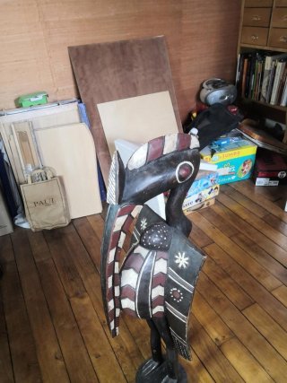

The room and the scanner from below
Bird from the right

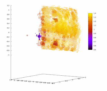

3d scan of the room : emitter is the red circle, and the room is viewed from the left. The color encodes the distance to the emitter.
