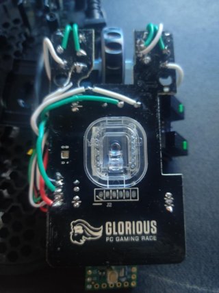

I modified an existing 1000Hz mouse and made it 8000Hz thanks to the Teensy 4 its USB high speed capable chip.
The mouse also has hardware debounced microswitches similar to how a flip flop operates.
Can't say going from a 1000Hz to 8000Hz polling rate changes much but it feels slightly more responsive.
The mouse itself looks the same as before but without the RGB effects.
Pinout, code and a more detailed description can be found on my github: https://github.com/Trip93/teensy4_mouse
