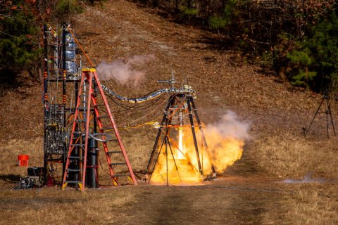

Hi all! We're the Yellow Jacket Space Program, Georgia Tech's 100% student-run liquid-fuel rocketry team. Last November, we successfully fired the YJ-1S, our first iteration LOX/kerosene rocket engine, for the first time.
The electronic control system for the engine was powered by 3 Teensy 3.6's. Details about how the system was built are below. One other student and I designed, built, and debugged this system in about 3 months in our free time between classes. It's not very well put together, but got the job done!
