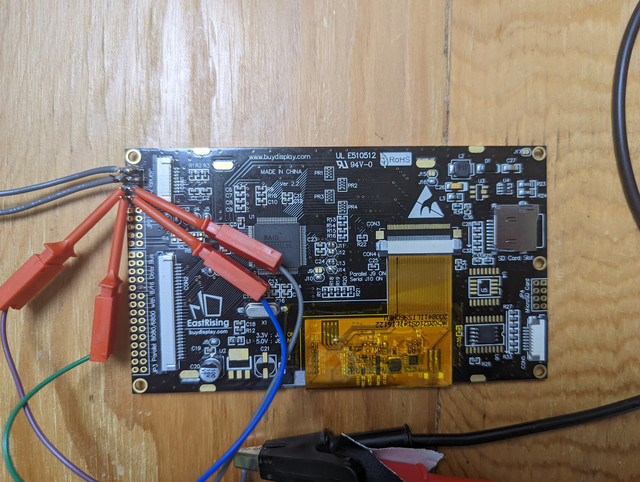

I'm having a heck of a time getting anything out of a BuyDisplay 5" EVE RA8875, no touch on a teensy 4.1. Link: https://www.buydisplay.com/5-inch-tft-lcd-module-800x480-display-controller-i2c-serial-spi
SPI pin header, 4-wire, 3.3V. Tried every library I can find, nothing seems to turn on the backlight consistently, randomly I can get garbage out. I scoped the SPI bus, I can see it writing and reading, current goes up, acts like everything is working... sometimes, other times its just a dead fish. If it does it's just garbage on the screen if the backlight even works. Seems totally random, I can unplug and plug it and sometimes it will throw up some garbage like the buffer is getting over run or something. I tried two screens, two different 4.1's. Testing on a breadboard, grounded all the GND pins on the teensy, 10k pull up resistors on the data pins, screen is powered by a bench supply, tried cutting the pad and powering everything off the bench, no change. Then pulled an awesome move and drove one of the screens at 13.3V and smoked it. I tried running the screen in 3 wire mode and 4 wire mode (switching the jumpers), no change. Nothing else is on the bus or connected. Adafruit lib will kind of work in the sense I can poll and wait for the screen to respond and display some junk. I'm getting nothing out of the sumotoy and its branches and recent updates. I saw Paul's example and it looks like most people are using the parallel bus pins and using the reset and interrupt pins. I tried adding those pins and the reset seemed to get junk more often but not constantly. Odds are I damaged both screen seems unlikely, I had checked everything 20 times by the time I hooked up the 2nd screen and teensy, but at this point I feel like I'm out of ideas.
Does anyone have a working example with that screen on a 4.1. Will it work with the SPI Pin header? Is there a library that works I might have missed?
Paul I was a bit confused by the Teensyduino, I'm using VSCode so I can't install it. I saw your post that you had updated libraries in it for RA8875 but the github for it does not have a RA8875 package. Where might I go to just get the packages?

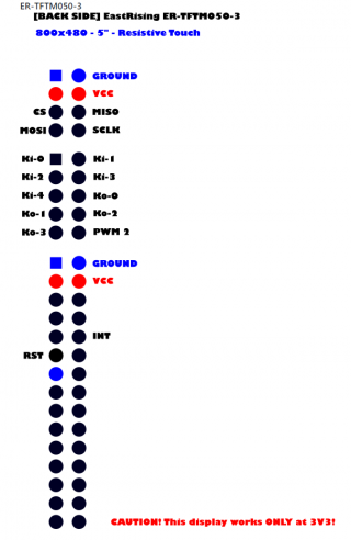

PIN OUT ON THE SPI PINS
4.1 -> LCD
GND -> 1-2
3.3 -> 3-4
CS 10 -> 5 CS
MISO 12 -> 6 SDO
MOSI 11 -> 7 SDI
SCK 13 -> 8 SCLK

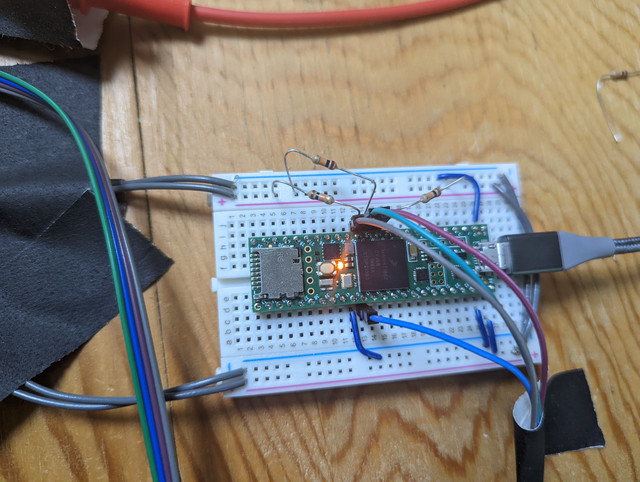

The other thing. How are you driving the display. If from the 3.3v pin of the T4.1 you may not have enough power to drive the display but that is a guess. I have the -5 version of the display which allows you to drive it from the 5v so works better for me. You also may need to hook up the backlite to 3.3v or tie it to a pin and drive it high on startup.

I am powering in on both the VCC and GND pins on the SPI header. Tomorrow I will try putting something more beefy on it.
I did see that Lib but he had mention in another thread he had updated the version for Teensyduino recently but that one has not been updated in 6-7 years, I tried the "v4" version but had no luck.

Configuration: 4-Wire SPI Pin Header, 3.3V, No Touch, ER3300-1 Fontchip, No EXT SD reader
Screen Details: https://www.buydisplay.com/5-inch-tft-lcd-module-800x480-display-controller-i2c-serial-spi
Screen Datasheet: https://www.buydisplay.com/download/manual/ER-TFTM050-3_Datasheet.pdf
Note: Teensy 4.1 is running on bench power not USB, pad is cut. Bench supply is at 3.4V, low but it seems to be working just fine.
PIN OUT Teensy 4.1 to Display
4.1 -> LCD
GND -> 1-2
3.3V -> 3-4
CS 10 -> 5 CS
MISO 12 -> 6 SDO
MOSI 11 -> 7 SDI
SCK 13 -> 8 SCLK

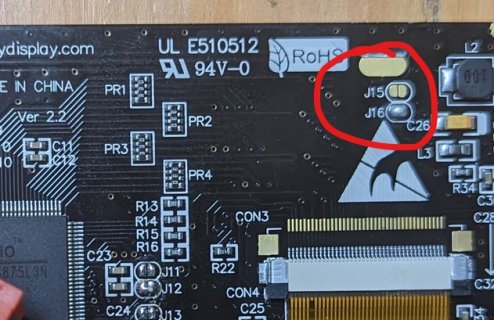

If I am looking correctly at your display:
I believe it is configured for an external BL pin (Page 13 on the datasheet)
I believe that with this configuration you probably need to hook up signal to I think pin 14 on the other connector...
Alternative is to change those two jumpers and which case you can turn on the backlight

I did see that, thou I think it is configured for the internal not external. It's why I was throwing every command related at it. J15 open, J16 short, is internal. That said, I did not try switch to external, I know its PWM but I assume if I just short that to the 3.3 rail it will max it. At this point I have nothing to loose and I will give that a try.

Have a couple of suggestions.
1. Hook up RST to pin 8, From Sumotoy's wiki.
2. Start with the benchmark example (good test) to start (I usually try that sketch first to make sure of my connections (examples -> RA8875_t4 -> Teensy 3 -> benchmarks
3. 40Mhz may be a bit fast - believe default is about 18Mhz - would start with the default begin, The SPI Speed in the begin is for the SPISpeed and SPIReadSpeed. The default value is 6Mhz. The notes we put in for both is don't go higher than 22Mhz. But definitely start at 18Mhz
tft.begin(RA8875_800x480);
4. Recheck your connections is still not working - personally I use male-female connectors between the breadboard and the display.
5. I usually don't use pullups on SPI when just testing a display but...

I just pulled out my 5 inch ER-RFTM050-2 display (5v)
It looks like it has the same BL configuration as yours as well as the same pinouts
J15Open,J16Short:SelectBacklightControlSignalwithRA8875'PWM’
It seems to work without setting the BL. Of course I am using RST connected the T4.
I would check you wiring and not use BL.
EDIT: Just as a double check. Make sure you have the 3.3v version and not the 5v version. Look for J8. If its open then its the 5v version, if shorted then its 3.3v.

Were you using your on the 8 pin header or the 40 pin? Did you need the reset? Pretty sure I damaged mine some how but it would not do anything without the RESET, at least not with the t4 lib.
All connections were using the 8pin headers except for RST which is on the 40 pin header. I have rst attached to pin 8 but could use any digital pin. Never tried it withou using rst or setting rst 255? May try that in the morning.
