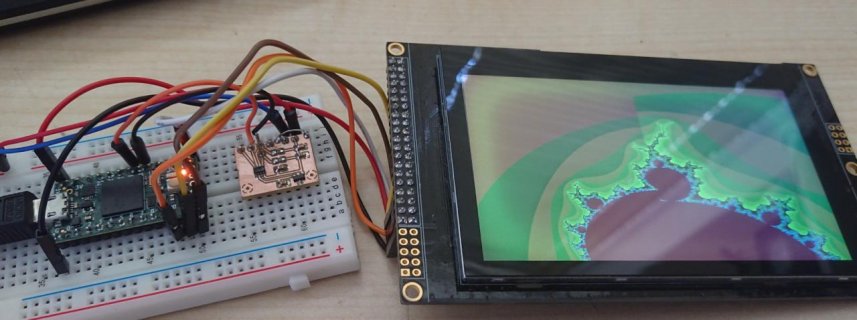

Hi all, My projects are running fine with a Teensy 3.6 but for better performance I like to use the Teensy 4, I use a RA8875 display from Buydisplay but when compiling I get a error. What can I do to get my programs to work with the new Teensy.

RA8875.cpp:476:11: error: cannot convert 'volatile uint32_t* {aka volatile long unsigned int*}' to 'volatile uint8_t* {aka volatile unsigned char*}' in assignment csport = portOutputRegister(digitalPinToPort(_cs));//pinMode(_cs, OUTPUT);

I changed a bit the RA8875.ccp and the RA8875.h and have no any errors when compiling..... connected my RA display but nothing on the screen. I noticed that the clock on 13 (LED) goes more bright so I think something is working?
I added the __IMXRT1062__ where is was needed in the .cpp ..... that's solve the errors for the Teensy4 what else can be wrong?

Ok the link you gave me when to the master branch for the library - you need to download this branch: https://github.com/mjs513/RA8875/tree/0.79b11p10
I just compiled your sketch without a problem and checked the 0.79b11p10 branch and it has the benchmark.ino is in the teensy3 directory. Easiest thing to do is to place the downloaded directory in your Arduino libraries folder and delete the RA8875 folder in the ….\arduino-1.8.9\hardware\teensy\avr\libraries folder

First I run many displays from Buydisplay 4.3, 5 and 7" runs perfectly with a Teensy 3.6.
My test display is a RA8875 Buydisplay 4.3 " 800 x 480 pixels.
Connections CS 10, MOSI 11 an MISO 12 SCK 13, I connected the RA displays many time to the Teensy 3.6 without any issues.
The supply is 5V (measured 4.98V)

/home/holstein/Arduino/libraries/RA8875-0.79b11p10/RA8875.cpp:476:11: error: cannot convert 'volatile uint32_t* {aka volatile long unsigned int*}' to 'volatile uint8_t* {aka volatile unsigned char*}' in assignment
@mjs513 and @pd0lew - I confirmed it does not build...
Looks like in the last set of changes made to RA87875.h
There were several #include lines that changed from:
#include "_settings/xxx"
to
#include "_include/xxx"
I changed all of these lines to _settings and it does build. I do see some warnings about generic... SO not sure if this is right?

The tiny PCB is home made a AD7991 I2C 12 bits works also very nice with the T4.
@Kurt,
I included the new library's, it compiles without errors and runs smoothly.
View attachment RA8875-0.79b11p10.zip

Aha there must be changed one line too for the RA8875Usersettings.h this will speedup the thing/
#if defined(SPI_HAS_TRANSACTION)
//SPI transaction enabled library----------------------
#if defined(__MK20DX128__) || defined(__IMXRT1062__) //[Teensy 3.0 , 3.1 , 3.2]
const static uint32_t MAXSPISPEED = 23000000UL; //don't go higher than 22000000!;
