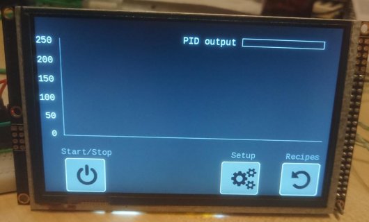

Hi all,
For my hotplate controller and is made with a cheap RPI 9488 type display and a STM32 and works fine, I like to convert this to my fantastic RA8875 display but I use tft.drawBitmap but this is not available in the RA8875 is there a solution?
Thanks for help as always.

As you said there is no direct function call for tft.drawBitmap however, if you look at the SDfatTest example in the Teensy3 folder it will show you how to read a bmp from a SDCard and display it.
If you want to use bmp files encoded as arrays with PROGMEM you might check out the load2424bitimages example.
In both cases you are going to be reading in the pixels from a file or an array and then drawing the pixels to the screen. My guess is that the STM32 function drawBitmap is following that same basic flow.
Hope this helps
Hi Mile,
This not that easy I suppose please read below, is it not possible to use AdafruitGFX for the drawBitmap ?
Unless I have an old version of the adafruit RA8875 library I didn't see a drawBitmap function in their library. I did find a similar function to what I referenced. If you look at the ILI9488 drawBitmap function in the library

I would suppose we could add a similar function for drawBitmap. Haven't tried your example yet have to go dig out my RA8875 first.
The simple answer is probably no, to using drawBitmap.
Again it would not be that hard roll your own or add it to library.
That is it already has writeRect...

Hi Mike, Kurt,
For me a bit difficult can you look at the code and is it possible to adjust my code with your function see below.
Compile works but not the drawBitmap.
Thanks.

Note: I put code tags around your code to make it easier to read.... It is the # button in the toolbar...
Did you try simply pasting in the function I mentioned?
And change your commented out calls like:
       //tft.drawBitmap(bx.x+(bx.w-byte0)/2, bx.y+(bx.h-byte1)/2, bx.bm+2, byte0, byte1, bx.swcolor);  // draw the button symbol (
to simply be:
       mydrawBitmap(bx.x+(bx.w-byte0)/2, bx.y+(bx.h-byte1)/2, bx.bm+2, byte0, byte1, bx.swcolor);  // draw the button symbol (
Note: sometimes Arduino does not always generate the proper forward reference so you might need a definition for it some where earlier up in sketch before first call.
Also note sometimes when typing stuff in on the fly there could be minor typos, like the my function should have the void return value at start...
extern void Adafruit_GFX::drawBitmap(int16_t x, int16_t y, const uint8_t bitmap[], int16_t w, int16_t h, uint16_t color);
This is going to sound funny but where are you defining the bitmaps for the buttons? Looks like the bitmap names are in your scr array but don't see how it gets there?
