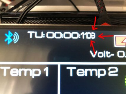

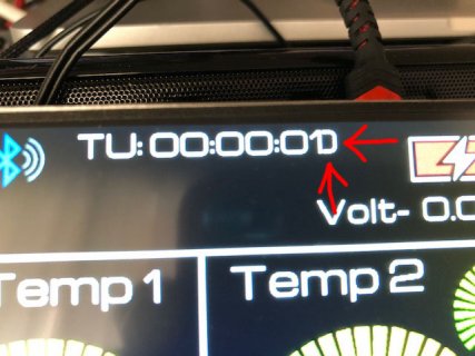

int16_t xcursor = tft.getCursorX();
tft.fillRect(xCursor, fieldY, (fieldX_end - xcursor), field_height);

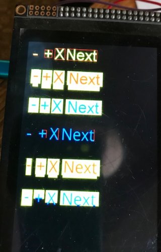

Just wanted to know if you have your RA8875 display working with the T4x. For some reason its not working for me with the T4.1. I tried it with a T3.5 and it works without a problem?
The one I am running is on a T4. Maybe you are setup with non-standard pins like T14 for SCK?

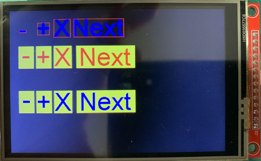

void drawTextWithBoundingRect(uint16_t x, uint16_t y, const char *str, ILI9341_t3_font_t *font) {
int16_t x1, y1;
uint16_t w, h;
tft.setFont(*font);
tft.setCursor(x, y);
tft.getTextBounds(str, x, y, &x1, &y1, &w, &h);
tft.print(str);
tft.drawRect(x1, y1, w, h, RA8875_RED);
void drawCenteredText(uint16_t x, uint16_t y, uint16_t w, uint16_t h,
const char *str,
ILI9341_t3_font_t *font,
uint16_t bg, uint16_t text_fg, uint16_t text_bg) {
tft.setFont(*font);
tft.fillRect(x, y, w, h, bg);
if (text_fg == text_bg) tft.setTextColor(text_fg);
else tft.setTextColor(text_fg, text_bg);
tft.setCursor(x + w / 2, y + h / 2, true);
tft.setClipRect(x, y, w, h);
tft.print(str);
tft.setClipRect();
delay(3000);
while (!Serial && millis() < 5000) ;
Serial.println("Initializing TFT display");
// begin display: Choose from: RA8875_480x272, RA8875_800x480, RA8875_800x480ALT, Adafruit_480x272, Adafruit_800x480
tft.begin(Adafruit_800x480, 16, 15000000);
tft.fillWindow(RA8875_BLACK);
tft.setTextColor(RA8875_YELLOW);
tft.setTextSize(2);
tft.setRotation(1);
tft.setFont(Arial_40);
drawTextWithBoundingRect(20, 20, "-", &Arial_40);
drawTextWithBoundingRect(60, 20, "+", &Arial_40);
drawTextWithBoundingRect(100, 20, "X", &Arial_40);
drawTextWithBoundingRect(140, 20, "Next", &Arial_40);
drawCenteredText(20, 100, 35, 50, "-", &Arial_40, RA8875_YELLOW, RA8875_RED, RA8875_YELLOW);
drawCenteredText(60, 100, 35, 50, "+", &Arial_40, RA8875_YELLOW, RA8875_RED, RA8875_YELLOW);
drawCenteredText(100, 100, 40, 50, "X", &Arial_40, RA8875_YELLOW, RA8875_RED, RA8875_YELLOW);
drawCenteredText(150, 100, 130, 50, "Next", &Arial_40, RA8875_YELLOW, RA8875_RED, RA8875_YELLOW);
drawCenteredText(20, 200, 35, 50, "-", &Arial_40, RA8875_YELLOW, RA8875_BLUE, RA8875_BLUE);
drawCenteredText(60, 200, 35, 50, "+", &Arial_40, RA8875_YELLOW, RA8875_BLUE, RA8875_BLUE);
drawCenteredText(100, 200, 40, 50, "X", &Arial_40, RA8875_YELLOW, RA8875_BLUE, RA8875_BLUE);
drawCenteredText(150, 200, 130, 50, "Next", &Arial_40, RA8875_YELLOW, RA8875_BLUE, RA8875_BLUE);
drawTextWithBoundingRect(20, 300, "-", &OpenSans40);
drawTextWithBoundingRect(60, 300, "+", &OpenSans40);
drawTextWithBoundingRect(100, 300, "X", &OpenSans40);
drawTextWithBoundingRect(140, 300, "Next", &OpenSans40);
drawCenteredText(20, 400, 35, 50, "-", &OpenSans40, RA8875_YELLOW, RA8875_RED, RA8875_YELLOW);
drawCenteredText(60, 400, 35, 50, "+", &OpenSans40, RA8875_YELLOW, RA8875_RED, RA8875_YELLOW);
drawCenteredText(100, 400, 40, 50, "X", &OpenSans40, RA8875_YELLOW, RA8875_RED, RA8875_YELLOW);
drawCenteredText(150, 400, 130, 50, "Next", &OpenSans40, RA8875_YELLOW, RA8875_RED, RA8875_YELLOW);
drawCenteredText(20, 500, 35, 50, "-", &OpenSans40, RA8875_YELLOW, RA8875_BLUE, RA8875_BLUE);
drawCenteredText(60, 500, 35, 50, "+", &OpenSans40, RA8875_YELLOW, RA8875_BLUE, RA8875_BLUE);
drawCenteredText(100, 500, 40, 50, "X", &OpenSans40, RA8875_YELLOW, RA8875_BLUE, RA8875_BLUE);
drawCenteredText(150, 500, 130, 50, "Next", &OpenSans40, RA8875_YELLOW, RA8875_BLUE, RA8875_BLUE);

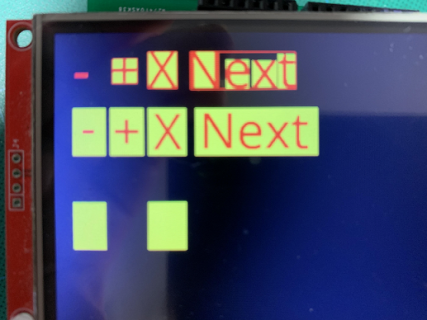

uint16_t y_loc;
int16_t x1, y1;
uint16_t w, h;
tft.setFont(*font);
tft.print(str);
const char *str,
tft.setFont(*font);
tft.print(str);
tft.setClipRect();
void nextPage()
Serial.println("Press anykey to continue");
while (Serial.read() == -1) ;
while (Serial.read() != -1) ;
#ifdef HAS_8875
#else
tft.fillScreen(RA8875_BLACK);
tft.setCursor(0, 0);
delay(3000);
// begin display: Choose from: HX8357_480x272, HX8357_800x480, HX8357_800x480ALT, Adafruit_480x272, Adafruit_800x480
#ifdef HAS_8875
#else
tft.begin();
tft.setTextSize(2);
tft.setRotation(1);

I just put in a hack version that the opaque font code calls off to a new fillRect function that does clipping.
The current code did not do any clipping... Not sure if it will impact other parts or not, but test cases appear to work better.
