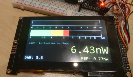

ok. messed it up - think I got my branches confused. I pull all the changes now into the RA8875 branch( https://github.com/mjs513/RA8875/tree/RA8875_t4 ). With the corrections to a couple of the files in the subdirectories (yes I missed those but I went over each one individually to make sure - already caught your comment in post #23.
Made one other change for the 1062:
so the display should be supported on all SPI ports (SPI, SPI1 and SPI2).
@KurtE - did I do that one right or did I miss something? Your RA8875 display may work now for you.
