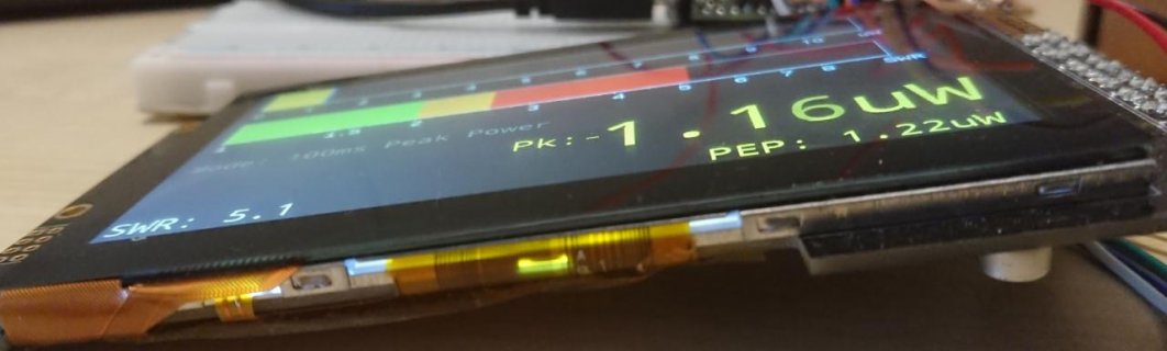

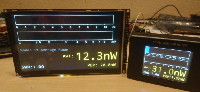

So that leaves us with two options, 4.3" and 7". Price difference is only $5.50.
Don't know which one to choose. I'm afraid the 4.3" will be too small for my poor eyes and the 7" too big my application.
According to the datasheets the 4.3" has an IPS panel and the 7" a TN panel.
Which one do you prefer in terms of viewing angle, image quality?
Are there any reasons you would choose one over the other?
@neurofun
The viewing angle from both displays are awesome 4.3 and the 7" I can not choose for you but the 4.3 " is a perfect screen also the 7" both 800 x 480 pixels.
So make your choice ...... the small display is a ILI9341.
