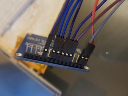

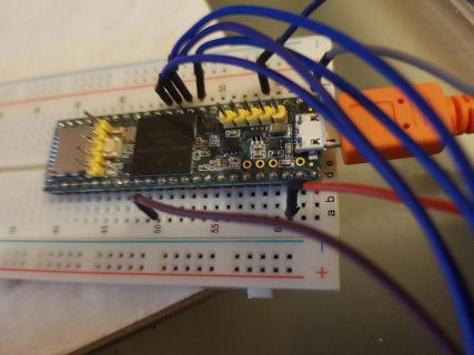

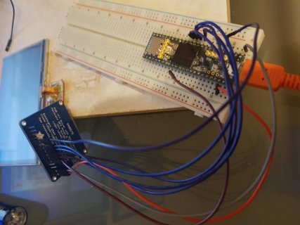

Compare your wires to the 3rd photo on msg #15. Notice the RA8875 "VIN" pin connects differently on yours than on the known-good photo.

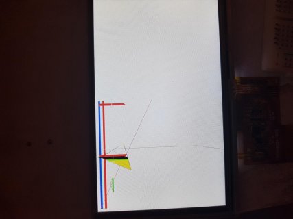

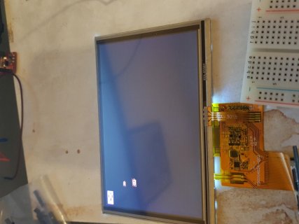

now the code run execpted touchscreen (this is another problem)

there is no problem with RA8875 ?
Please note! The RA8875 does not tri-state the MISO pin, it should not share that pin with any other SPI device (including an SD card reader) without the use of a 74HC125 or similar
