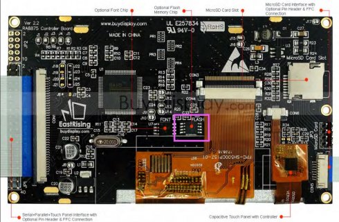

Thanks Morgan. Do you know if either library can successfully address (write/read) external flash memory on the buydisplay board? The RA8875 datasheet mentions how to read from it, but not how to write. Also because this is an SPI connection between RA8875 and the flash memory, would it be limited to the same 18MHz?
You need to think of working with that memory as you talking to the RA8875 and telling it what to write. "Write an 'A'" "Did you write it yet?" "OK, write a 'B'"...
So loading into the flash memory is going to be slower than normal memory. With some work, it could be made almost as efficient as normal memory. BUT the SPI speed used to talk to that chip is subject to the same limitations as the main SPI interface. As far as I can tell from the datasheeet, it cannot be faster. I've never used it but I have used the font ROM and it seems slow compared to directly loading bulk data.
Then you're subject to the same speed limitation when you try to get that image back off the flash chip and into the RA8875 working memory. If the SPI is slower like I think, then it's going to be slower than sending it from the Teensy directly.
The flash chip only makes sense if you've got lots of medium-to-small images and you can efficiently use the time that the RA8875 is working on transfers to do something else with the Teensy. A big screen update which requires loading two or more images out of flash will force your Teensy to wait for the first image to transfer before it can send the command to transfer the second image.
Reading the RA8875 datasheet, looks like the flash SPI interface supports dual and quad lines, potentially doubling or quadrupling the SPI speed. What I don’t see, is how to write data TO the flash chip. Buydisplay sells these flash chips meant for their displays:
https://www.buydisplay.com/new-winbond-ic-chip-flash-128m-bit-w25q128jv-sop8-package
It’s datasheet says it supports up to 400MHz SPI. But without a documented write register I’m not sure what we can do with it.
The chip may support 400MHz but the RA8875 only has a limited system clock speed.
Since there doesn't seem to be a write command in the RA8875 register list then perhaps the flash ROM is read-only. (That's why it's called a ROM?) So you would have to program it before soldering it onto the RA8875 carrier board.
There does appear to be a couple of faster SPI modes available to talk to the flash chip. They seem to turn the MOSI line bidirectional so that it can send back 8 bits in only 4 clock cycles. I've never seen that used anywhere. At best, it could double the speed of loading data off the flash chip.
Ok, upon further research it looks like the only option is to pre-program the flash memory and then solder it to the board. Not very practical, the least buydisplay could have done was put ICP headers in there, but I also don't see why they wouldn't have programmed the RA8875 to be able to transfer data to the flash chip (the chip they sell can be re-programmed/erased, and the RA8875 datasheet calls if flash).
Apologies for cluttering this thread, I've got my answers. Thanks @MorganS!
