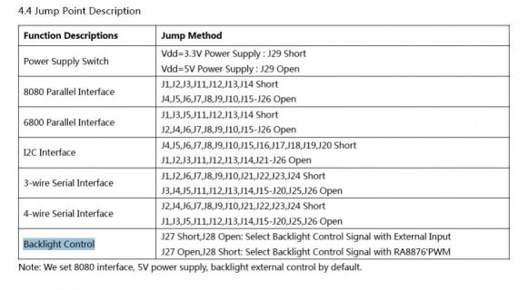

Another ER-TFTM0784-1 black screen - gotchas?
Interloper here from ESP32-land! I've got one of these 1280x400 displays (ER-TFTM0784-1) that I'm having trouble getting working at all, and the folks here seem to be most experienced with it, so hope you don't mind me joining the conversation...
I've tried various drivers but for now am starting with https://github.com/caiannello/ER-TFTM0784-1 since the Due code is the easiest to adapt (and largely the same as BuyDisplay's demo code) - I'm using Arduino framework so only minor mods needed to SPI.
Checklist:
  • Ordered 4-wire SPI, 5v, no touch screen - all jumpers seem in order
  • Using USB power into VSS and VDD, rest of pins (and extra ground) direct from MCU (ESP32 is 3.3v)
  • Board comes as default with external PWM control, so commented out the PWM code - driving this directly, and I see the backlight
  • Serial debug confirms the RA8876 is initialising - eg LCD_StatusRead() shows 01010000 before RA8876_SDRAM_initail(), then 01010100 after it
  • So my SPI seems working (testing @ 10Mhz)
  • Double/triple checked my wiring/pins for the SSD2828 (using pins 31/32/34/35 on the display)
But I just get a black (with backlight) screen (although serial reports back the demo stages progressing). Bad hardware seems unlikely given both the backlight and RA8876 seem to be working?
I'm guessing something up with the SSD2828 side - since it's just one way I don't know if it's working. The bit-banged SPI calls spi_delay() - this calls nop, unsure if this would be any different on ESP32, I've tried it with eg delayMicroseconds(10) instead but still no luck.
Any gotchas from anyone who has this working?
Failing that, can you point me (a teensy novice) to a) the minimum Teensy needed for the current library, and the current branch/version that supports this specific display so I can try the display with a known working setup?
So... ignore the above... after spending the entire weekend on this, finally found the missing piece! Some more obtuse searching eventually found this post: https://groups.io/g/keithsdr/topic/success_with_7_8in_400x1280/82704422
The basic gist is that there are 2 differing bytes in the SSD2828 code:
Or if you want to manually make the changes yourself simply search this file (in your Arduino/libraries) for SPI_WriteCmd(0xBA) and change the SPI_WiteData immediately following it from 0x20 to 0x25
Changing this has Craig's port of the BuyDisplay demo working, and also the RAIO RA8876_Lite library (with the SSD2828 init added). Now I have that working I'll take a look at the Teensy version, which seems to be enhanced, to see how easily I can port it.
I note the "incorrect" version is in the libraries@
https://github.com/blackketter/Ra8876LiteTeensy
https://github.com/wwatson4506/Ra8876LiteTeensy/tree/Ra8876LiteTeensy-ER-TFTM0874
Folks earlier in this thread seem to have this working - so I wonder if perhaps the TFT got updated sometime requiring this change?
Anyway, hopefully this helps the next person searching for this. I can't figure out how to reply on groups.io :| so Dave, if you are here, many thanks :)

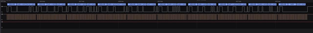

We have it working with ILI9341 both my library (_t3n) with frame buffer support and yesterday added code to emulate frame buffer for _t3. Works also with out St7735/89 library and ILI9488...
But have also now been playing with the RA8876 and right now in particular to try to use offsecreen memory to update such that you don't see the window painting slowly over several seconds...
Have a version of it now that works with t4.1 with extmem, where I generate a full frame, and then send the whole frame
The update code now looks like:
    tft.useCanvas();
    tft.putPicture_16bpp(0, 0, g_tft_width, g_tft_height);
    tft.startSend();
    SPI.transfer(RA8876_SPI_DATAWRITE);
    SPI.transfer((uint8_t*)g_frame_buffer, NULL, g_tft_width*g_tft_height*2);
    tft.endSend(true);
    //tft.putPicture_16bppData8(0, 0, g_tft_width, g_tft_height, (uint8_t*)g_frame_buffer);
    tft.updateScreen();
Sort of hacky... was using the commented out function, which is outputting one byte at a time using transfer.
This cut the time down from over 7 seconds to about 3.5...

As for 7" to work as I mentioned I now have two. They both use the ER-TFT070-6 v1.1 boards. One worked with your tft.backlight(true), the other does not.
The differences was in the soldered jumpers on the board:
When I looked at the boards, J27 and J28 were different on the two boards:
From their PDF
On my new board I am playing with, I did route connection for the BL connection, so connected it up and told the IO pin to go HIGH and then the display worked.
This is to pin14 of the display
