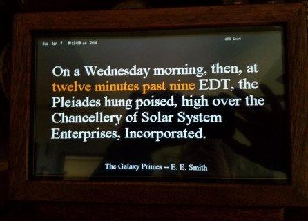

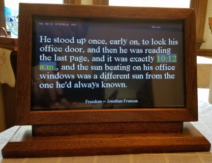

About a year ago I built a project around a ER-TFTM101-1 purchased from buydisplay.com. I included a capacitive touch-screen and the GT30L32S4W (aka ER3304-1) font ROM. I hacked up the RA8876 driver, keeping only what I needed. I'm including some photos of the project, a "Literary clock" like http://literaryclock.com. My biggest change to the RA8876 driver was detecting and properly handling characters with descenders, like 'g', 'j', 'p', and 'y'. The included photos show the before and after the code change.
Before:
After:
A video of the clock in operation is at https://www.youtube.com/watch?v=YcSkkDHdfg0
I'm happy to share the code if you're interested.
Before:
After:
