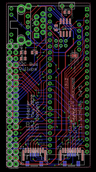

I've ordered a Teensy 4.1 and started on updating my PCB to use the 16-bit parallel interface. For an extra $2 worth of board area, I've added USB, Ethernet and CAN BUS. With the 14 pins I want to use for my buttons and knobs, every single pin on the Teensy 4.1 is in use, except for pgm/vbatt/gnd across the middle. The routing just barely works on a 2-layer board.
Thanks for that sketch! I don't have a mouse hooked up but I do have a touchscreen, so I've been experimenting with making an animated graphics cursor in my touchscreen example. The RA8876 lets you upload an image to the cursor that's currently displayed and it's only a little bit glitchy.
