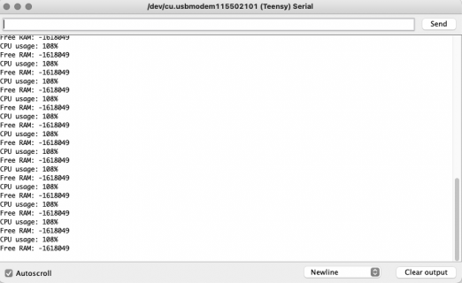

I am trying to measure cpu and ram usage on my teensy 4.1.
I found this sketch on an older post on this forum, however when I run it I get inaccurate results. The cpu usage shows over 100%, do I need to modify it to for the increased processor speed on the 4.1.
Any ideas would be greatly appreciated thank you.
Not sure of the source post used for ref, but it seems to be T_3.2 pr 3.1 with default max F_CPU of 96 MHz
Adding these two lines before the ELSE at the top:
[B]#elif F_CPU == (600000000L) //600mhz
#define UNLOADED_IDLE_COUNTS 13600000
[/B][COLOR="#FF0000"]#else //96mhz[/COLOR]
Then shows ZERO% usage, and when 8ms each 10ms is used it shows 84% used which may be about right.
The "Free RAM" is horribly wrong as well - there are other posts that show the proper way to calc FREE RAM on 1062.
The way that code is written - it "CALLS" a couple of empty functions as the baseline.
For that Here showed 13627933 for Idle_Counter where the above number gives 0%
It then shows 84% with delay(8) and 8 ms delay, with overhead of call to yield() etc, replacing with delayMicroseconds(8000); drops that to 83%
Some of the extra 3% may be in even calling the function in Run_Tasks(), which the compiler may optimize away given they are empty.
