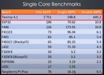

First unofficial Arduino IDE support for the Pico: YouTube and on Github.
From the video:
@3m31s: "And as last time, the Teensy 4.1 is in a different class" :cool:

I am not promoting in any way the raspberry pico on this forum but I had a week off to experiment and started to port the MCUME project on that MCU.
Initial release at:
https://github.com/Jean-MarcHarvengt/MCUME/blob/master/README.md
We indeed are far from the Teensy 4.1 performance.
Amiga and Atari ST emulator or any 68000 based system will not be emulated on this system.
Even the C64 emulation is struggling without sound.
So far Atari2600, Coleco, Odyssey, Atari800, Zx81 and Spectrum are running.
SDK is not as great as I expected. Lot of examples but problematic when you start using all feature at same time.
I enjoyed using their VGA library however I had some strange behavior. SD card support on that device was hopefully addressed by another guy. Many DMA IRQ conflict from the various drivers. For sound I reduced it to PWM interrupt based audio.
I saw that Arduino SDK was now available for the pico but VGA was not yet part of it . Anyhow, I don't have more plan on the device.
It is cheap indeed. Probably the cheapest MCU that can deliver VGA with such quality for 4 euros.
I have seen other interesting emulators on the device but the code has to be tweaked for performances.
So nice and cheap device but Teensy MCU are indeed another category!
