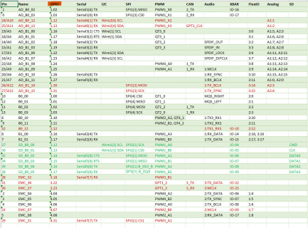

There are several ways to find out which pins or on which port, I often look that the spreadsheet I setup during the beta tests of the board. Example page in GPIO pin order.
Note: the GPIO column which this page is sorted on. where pin 1 is shown as GPIO 1.02. GPIO1 maps to GPIO6 (2->7, 3->8, 4->9) The lower numbers are when the pins are in the standard mode, and the higher numbers are when they are in high-speed mode.... We switch all of the pins to the higher numbers during sketch startup (startup.c)
And the .02 is this is bit 2 of the 32 bit register.
