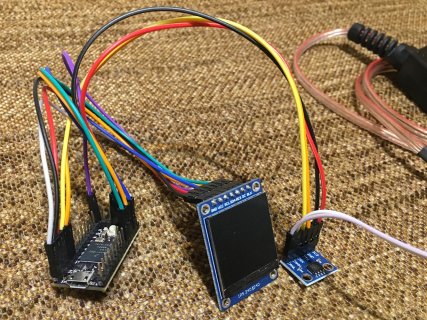

Hello, I am new to microcontroller programming. But I really want to create an additional monitor with information output to the car (Volkswagen Jetta 6). I have Teensy 4.0 and have already been able to connect a 240x240 display. But here's how to get information from the CAN bus of a car - I don't have enough knowledge. Perhaps someone was engaged in a similar task, I will be grateful for any advice and hint. Sincerely.

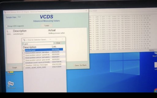

What I suggest you do is purchase a VCDS HEX-CAN V2 from Aliexpress and do some can sniffing using the T4 hooked up to the OBD port with a Y splitter (don't forget to use a CAN transceiver between the T4 and the OBD port)
Set VCDS to poll a single parameter and catch the messages with the Teensy vis Serial monitor to see what a request looks like and what a response looks like.
Here is what it looks like:

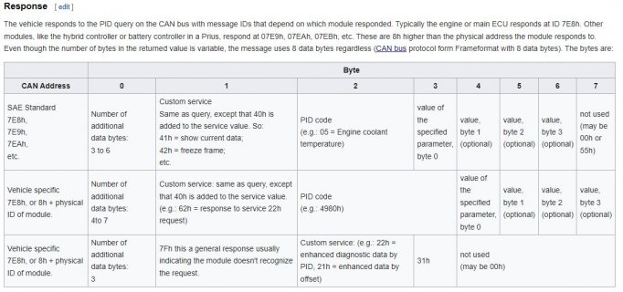

But you really need to learn how the CAN bus application layer works, and how UDS works.
Here are some links that will help you:
https://en.wikipedia.org/wiki/Unified_Diagnostic_Services
https://en.wikipedia.org/wiki/OBD-II_PIDs

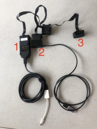

This is my setup to do CAN sniffing:
1. HEX V2 used with VCDS to send requests and see realtime data
2. Teensy 3.2 + TI sn65hvd230 CAN transceiver placed in an OBD2 connector
3. Y splitter that connects to both devices to the cars OBD port
I use a simple sketch on the Teensy that print's every CAN frame it see's (from either end: car or VCDS) onto the Arduino serial monitor. I then log each frame (request/response) and value.

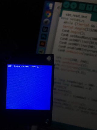

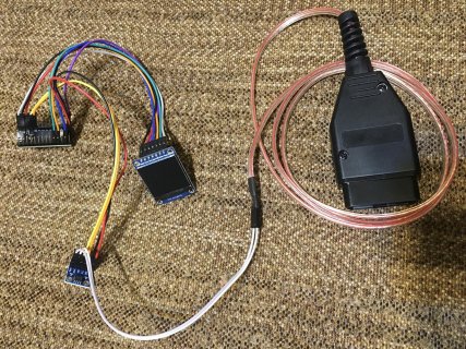

Rezo, thank you very much for the information, fortunately I have this transceiver. Today I will try to connect according to your example.
By the way, I plug into the OBD port, not directly to any of the available busses in the car. I was after true P&P :D
Rezo, thanks for the hints and code, this works and I'm glad it does!
Well, I'm continuing to work on the project.

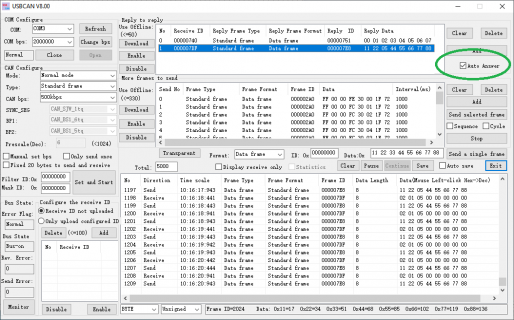

Took me some fiddling and using the CAN analyzer to get your code working.
Apparently the way the FlexCan library is invoked/called makes a difference.

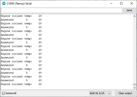

This is the serial monitor output:
I had the CAN bus analyzer set to auto-answer whenever a PID_REQUEST frame came in and send out a PID_REPLY frame with rxmsg.buf[2] set to 0x05:
Hope this helps.

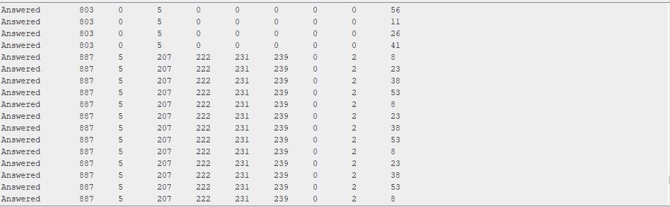

Thank you for you answer PaulS, I was checking and no luck but finally I change my transceiver for a new one (I alredy had it but I didn't remember) and now it connects and I have some communication, but the results are not the desired ones.
I would like to have the ones you have on your post but mine are different, for ENGINE_COOLANT_TEMP I gost this:

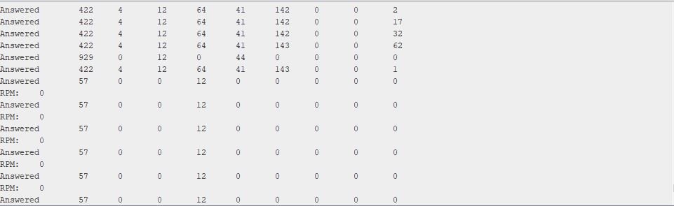

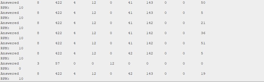

I tried to changed to RPM (0X0C) and I got something better:
the thing is that when the car is off I get the pid on buf 2 but when engine is on I get the pid on buf 3, the numbers seem to be good ones.
code is the same but just printing all id and bufs as seen in the image, so first number is id, next one is buf[0] and so on...:

From this page I read: "1 - 1,0C,2,"Engine RPM",0,16383.75,rpm,((A*256)+B)/4".
It's apparently generic OBD2. The RPM PID 0x0C only returns 2 bytes, so buf[0] and buf[1]. You can verify that by printing Serial.print(rxmsg.len);.
The formula is given as ((A*256)+B)/4. When I fill in buf[1] for A and buf[0] for B, I got something like 769RPM. Sounds reasonable.
Paul
Thanks for your answer PaulS, I am not able to get this 769rpm, getting any of the buf combination. As far as I can read on wikipedia and some other pages buf[0] is the number of additional bytes in the response, buf[1] should be 0x41 as it's the mode I am reading on, buf[2] should return the pid I asked for, in this case 0x0C and buf[3] and 4 should be the answer applying the formula.
https://en.wikipedia.org/wiki/OBD-II_PIDs#Service_09_-_Request_vehicle_information
But this is the answer I get (first number is the len of the answer):
I don't get the reply code (id) I should, on the buf[0] I get 4 additional bytes which seems reasonable, 2 are the answer, one the pid I asked for and the other one the method I am using to get the data. But on buf[1] I should get 0x41 which is 65 and I get the pid I asked for, on buf[2] I get nothing, and on buf 3 and 4, where I should get the data I get numbers that using the formula are bigger than 2000 when my car ir just beow 1000 (around 900).
On the webage you posted the link I realized that I cannot check the coolant temp (unfortunatelly) but,rpm should workd.
Thanks :)
That is a good idea. But do you still have this line in?
if ((rxmsg.id == PID_REPLY) or (rxmsg.buf[0] == ENGINE_COOLANT_TEMP) or (rxmsg.buf[1] == ENGINE_COOLANT_TEMP) or (rxmsg.buf[2] == ENGINE_COOLANT_TEMP)) {
Perhaps you should change that to:
if ((rxmsg.id == PID_REPLY){
And print out the length of the CAN reply message as well for diagnostic purposes:
Serial.print("\t");
Paul
But do you still have this line in? [CODE said:
if ((rxmsg.id == PID_REPLY) or (rxmsg.buf[0] == ENGINE_COOLANT_TEMP) or (rxmsg.buf[1] == ENGINE_COOLANT_TEMP) or (rxmsg.buf[2] == ENGINE_COOLANT_TEMP)) {[/CODE]
Yes I have it, if I remove all or conditions and just leave rxmsg.id nothing is showed. No answer as the reply is not the one it should.
Hmm, if you don't get a PID_REPLY at all, then something else is wrong. Perhaps it's a hardware/wiring issue?
I think you really need a CAN analyzer now to debug the issue.

Hello,
I already got an analyzer and I am trying to test, once I was able to see the data on the program and everything was good but when I tried to configure a result I lost all communication and now I cannot see anything on the analyzer (welll, the green light of receiving is blinking correctly), maybe I forgot something on the configuration of the analyzer.
Thanks
Your screen looks similar to my screen in message #12. Did you click the "Set and Start" button?
If it is still not working, exit the program. Unplug and replug the USB cable of the analyzer. Then start the program again.
Check the correct COM port [don't confuse it with the Teensy COM port] and click the "Open" button. Then click the "Set and Start" button.
That should be it.
Paul
It's strange, I was able to see the values once but now only green led is blinking and no way to see anything , without changing any wires, I will keep trying.
Thanks
