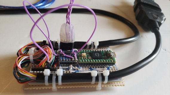

#include <FlexCAN.h> // TI SN65HVD230 CAN-bus transceiver module: CTX pin 3, CRX pin 4
static CAN_message_t msg;
static CAN_filter_t allPassFilter;
pinMode(LED_BUILTIN, OUTPUT);
while (!Serial) ; // wait for serial monitor
allPassFilter.flags.extended = 0; // 1 for extended/29 bit IDs
Can0.begin(500000, allPassFilter); // init CAN bus @ 500kbps
Serial.println("CAN initialized and listening");
if (Can0.read(msg)) {
Serial.printf("0x%08X", msg.id); Serial.print(" ");
Serial.printf("0x%04X", msg.timestamp); Serial.print(" ");
Serial.printf("%010u", micros()); Serial.print(" ");
Serial.printf("0x%02X", msg.flags); Serial.print(" ");
Serial.printf("0x%02X", msg.len); Serial.print(" ");
for (byte i = 0; i < sizeof(msg.buf); i++) {
Serial.printf("0x%02X", msg.buf[i]); Serial.print(" ");
Serial.println("");
Can0.write(msg);

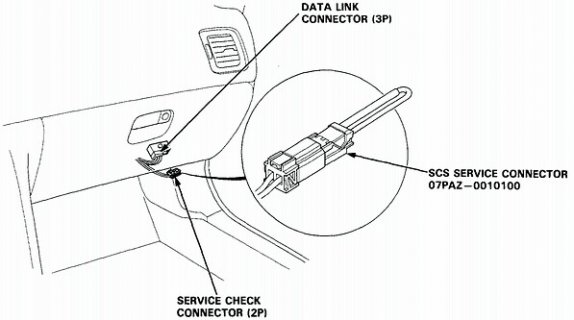

KeyOn-EngineOff should be enough to see CAN data or connect a scanner.My quick question is thus: did you have to do anything special
