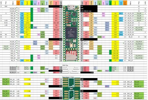

How to read schematic and figure out the pins... Note: I don't typically start off from schematic to figure which pin is which, As for most of the newer boards, I started experimenting in either Alpha or Beta mode of the boards, where Paul already generated the pin table... So had to generate tables starting from that side... Then usually generate excel document with pin information in different orders.
Which I usually keep up at: https://github.com/KurtE/TeensyDocuments
One page for T4.1 looks like:
I have another page with the pins in GPIO pin order. Note: my pin numbers use the port numbers in normal speed (1-5) which translate 6-9 in Defragsters. I kept mine in lower as it matches the document.
Now how from schematic: if you look at Pin 0 you see on schematic it is connected to AD_B0_03 on IMXRT .
Now if you look in the IMXRT1060RM.pdf file (can download from product page)... And look probably easiest place is Chapter 11 (IOMUXC) and do a search for AD_B0_03 you will find
the register IOMUXC_SW_MUX_CTL_PAD_GPIO_AD_B0_03 (P477 in the version of pdf I am looking at)
You will see in Mux Mode 5: 101 ALT5 — Select mux mode: ALT5 mux port: GPIO1_IO03 of instance: gpio1
So this pin is GPIO1 (or 6) and Pin 3 on it...
And it shows you all of the other things this pin can do like for a Hardware Serial port: 010 ALT2 — Select mux mode: ALT2 mux port: LPUART6_RX of instance: lpuart6

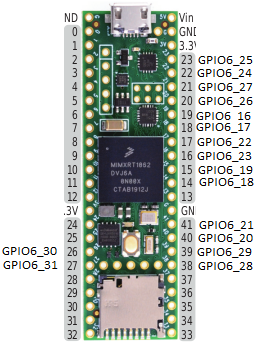

here is a sorted by (GPIO groups) outtake from core_pins.h
the core pins I assume is the pin number given to Teensy PCB
then GPIOx_DR is the data register

// here is one continuous block of 16 bits
// should be able to read like this
// uint16_t addr= (GPIO6_DR & 0xFF00) / 256;

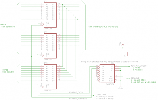

as you read in the comments above there is not additional 8 bits continuous
but that can easily be solved by multiplexing the address and data using 3x 74hc245
but think this approach will be the fastest possible
also need to mention that you have to use the
GPIO6_GDIR to set the data directions

I've got 5 level shifters. 2 set for input to the Teensy for the address lines, 1 set for the data lines and the direction can be controlled by the Teensy, and 1 set to input to the Teensy for certain signals (such as Phi2), and 1 more that has both a chip select and direction that can be controlled by the Teensy for some other lines.
What I screwed up on, in retrospect, is I should have figured on arranging the connections as per the GPIO0x pin registers(?) as opposed to what made the most sense by the physical wiring. But there are a couple other mistakes on the board and I have it hacked to work. I am hoping to at least prove the concept with this board then get a board made using all the lessons I learned.
