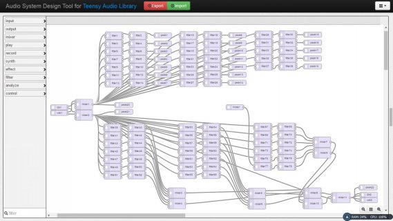

Hi everyone, this is a real-time vocoder code I developed a few days ago. It has two inputs: Voice In & Instrument/Synth In. It outputs the sound of the instrument with the voice syllables superimposed or somewhat combined with it. No extra libraries needed and no library modifications is needed, the original Teensyduino-supplied libraries work with it.
The idea is based on the block diagram of MFOS DIY Vocoder. I made a school project based on it a couple of years ago but I didn't made it to work properly (components out-of-stock in my country hahaha). At least by using a Teensy, my dream came true :D.
Sorry, the code is long but is worth it. Hardware used were Teensy 3.6, a board I found on my toolbox which has UDA1345TS 24-bit CODEC chip on it for I2C testing, a PC, and a headphone or speaker.
Test Tracks (zip file, 9.23 MB) is available (you need to extract the contents of it first), play it and input to Teensy and listen to Teensy's output.
UPDATE: Test Tracks + Output Recordings + ".ino" code + other stuffs (zip file, 13 MB) is also available through 4shared or Google Drive.

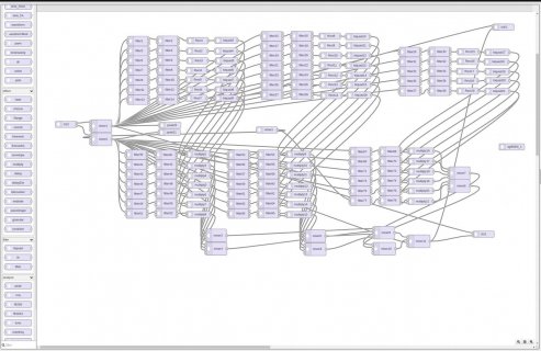

Nodes.jpg Nodes everyone?
 * 19-Channel Vocoder                                           *
 * Left input is voice input                                    *
 * Right input is instrument/synth input                        *
 * Input is both in I2S and USB, with programmable gain         *
 * Output is both in I2S and USB                                *
 * My 37-channel Vocoder does not work, all I heard was noise.  *
 * I didn't have an Audio Shield, I used UDA1345TS 24bit Codec  *
 * for I2S testing. Note, the code is a bit long (768 lines),   *
 * but it is commented for you to understand its functions.     *
 * Testing Parameters                                           *
 *  • Hardware: Teensy 3.6                                      *
 *  • Teensyduino Version: 1.35                                 *
 *  • USB Type: Serial + MIDI + Audio                           *
 *  • CPU Speed: 240 MHz (overclock)                            *
 *  • Optimize: Faster                                          *
 *  • Audio Input: USB (routed to MP3 player)                   *
 *  • Audio Output: USB (routed to headphone out)               *
 *  • Processor Usage Max = 69.84                               *
 *  • Memory Usage Max = 31                                     *
 * Using lower CPU speeds is possible, down to 168 MHz but you  *
 * need to adjust attack parameter (line 295).                  *
 * Memory usage isn't affected by CPU speed.                    *
 * Coded by Revalogics                                          *
#include <Audio.h>                                              // no libraries were harmed (modified)
#include <SerialFlash.h>
AudioInputI2S            i2s1;           //xy=171,527
AudioInputUSB            usb1;           //xy=171,559
AudioMixer4              mixer1;         //xy=315,510
AudioMixer4              mixer2;         //xy=315,572
AudioFilterStateVariable filter39;       //xy=481,645
AudioFilterStateVariable filter41;       //xy=481,691
AudioFilterStateVariable filter43;       //xy=481,736
AudioFilterStateVariable filter45;       //xy=481,782
AudioFilterStateVariable filter47;       //xy=481,828
AudioFilterStateVariable filter49;       //xy=481,874
AudioFilterStateVariable filter51;       //xy=481,920
AudioFilterStateVariable filter1;        //xy=488,112
AudioFilterStateVariable filter3;        //xy=488,158
AudioFilterStateVariable filter5;        //xy=488,203
AudioFilterStateVariable filter7;        //xy=488,249
AudioFilterStateVariable filter9;        //xy=488,295
AudioFilterStateVariable filter11;       //xy=488,341
AudioFilterStateVariable filter13;       //xy=488,387
AudioAnalyzePeak         peak20;         //xy=546,513
AudioAnalyzePeak         peak21;         //xy=546,552
AudioFilterStateVariable filter40;       //xy=620,644
AudioFilterStateVariable filter42;       //xy=620,690
AudioFilterStateVariable filter44;       //xy=620,735
AudioFilterStateVariable filter46;       //xy=620,781
AudioFilterStateVariable filter48;       //xy=620,827
AudioFilterStateVariable filter50;       //xy=620,873
AudioFilterStateVariable filter52;       //xy=620,919
AudioFilterStateVariable filter2;        //xy=627,111
AudioFilterStateVariable filter4;        //xy=627,157
AudioFilterStateVariable filter6;        //xy=627,202
AudioFilterStateVariable filter8;        //xy=627,248
AudioFilterStateVariable filter10;       //xy=627,294
AudioFilterStateVariable filter12;       //xy=627,340
AudioFilterStateVariable filter14;       //xy=627,386
AudioAnalyzePeak         peak7;          //xy=770,386
AudioAnalyzePeak         peak3;          //xy=771,202
AudioAnalyzePeak         peak4;          //xy=771,248
AudioAnalyzePeak         peak5;          //xy=771,295
AudioAnalyzePeak         peak6;          //xy=771,340
AudioAnalyzePeak         peak1;          //xy=772,110
AudioAnalyzePeak         peak2;          //xy=772,157
AudioMixer4              mixer3;         //xy=853,1023
AudioMixer4              mixer4;         //xy=854,1085
AudioFilterStateVariable filter53;       //xy=913,643
AudioFilterStateVariable filter55;       //xy=913,689
AudioFilterStateVariable filter57;       //xy=913,734
AudioFilterStateVariable filter59;       //xy=913,780
AudioFilterStateVariable filter61;       //xy=913,826
AudioFilterStateVariable filter63;       //xy=913,872
AudioFilterStateVariable filter65;       //xy=913,918
AudioFilterStateVariable filter15;       //xy=920,110
AudioFilterStateVariable filter17;       //xy=920,156
AudioFilterStateVariable filter19;       //xy=920,201
AudioFilterStateVariable filter21;       //xy=920,247
AudioFilterStateVariable filter23;       //xy=920,293
AudioFilterStateVariable filter25;       //xy=920,339
AudioFilterStateVariable filter27;       //xy=920,385
AudioFilterStateVariable filter54;       //xy=1052,642
AudioFilterStateVariable filter56;       //xy=1052,688
AudioFilterStateVariable filter58;       //xy=1052,733
AudioFilterStateVariable filter60;       //xy=1052,779
AudioFilterStateVariable filter62;       //xy=1052,825
AudioFilterStateVariable filter64;       //xy=1052,871
AudioFilterStateVariable filter66;       //xy=1052,917
AudioFilterStateVariable filter16;       //xy=1059,109
AudioFilterStateVariable filter18;       //xy=1059,155
AudioFilterStateVariable filter20;       //xy=1059,200
AudioFilterStateVariable filter22;       //xy=1059,246
AudioFilterStateVariable filter24;       //xy=1059,292
AudioFilterStateVariable filter26;       //xy=1059,338
AudioFilterStateVariable filter28;       //xy=1059,384
AudioSynthNoiseWhite     noise1;         //xy=1189,526
AudioAnalyzePeak         peak14;         //xy=1202,384
AudioAnalyzePeak         peak10;         //xy=1203,200
AudioAnalyzePeak         peak11;         //xy=1203,246
AudioAnalyzePeak         peak12;         //xy=1203,293
AudioAnalyzePeak         peak13;         //xy=1203,338
AudioAnalyzePeak         peak8;          //xy=1204,109
AudioAnalyzePeak         peak9;          //xy=1204,155
AudioMixer4              mixer5;         //xy=1317,1025
AudioMixer4              mixer6;         //xy=1318,1087
AudioFilterStateVariable filter67;       //xy=1350,641
AudioFilterStateVariable filter69;       //xy=1350,687
AudioFilterStateVariable filter71;       //xy=1350,732
AudioFilterStateVariable filter73;       //xy=1350,778
AudioFilterStateVariable filter75;       //xy=1350,824
AudioFilterStateVariable filter77;       //xy=1350,870
AudioFilterStateVariable filter29;       //xy=1356,107
AudioFilterStateVariable filter31;       //xy=1356,153
AudioFilterStateVariable filter33;       //xy=1356,198
AudioFilterStateVariable filter35;       //xy=1356,244
AudioFilterStateVariable filter37;       //xy=1356,290
AudioFilterStateVariable filter68;       //xy=1489,640
AudioFilterStateVariable filter70;       //xy=1489,686
AudioFilterStateVariable filter72;       //xy=1489,731
AudioFilterStateVariable filter74;       //xy=1489,777
AudioFilterStateVariable filter76;       //xy=1489,823
AudioFilterStateVariable filter78;       //xy=1489,869
AudioFilterStateVariable filter30;       //xy=1495,106
AudioFilterStateVariable filter32;       //xy=1495,152
AudioFilterStateVariable filter34;       //xy=1495,197
AudioFilterStateVariable filter36;       //xy=1495,243
AudioFilterStateVariable filter38;       //xy=1495,289
AudioAnalyzePeak         peak17;         //xy=1639,197
AudioAnalyzePeak         peak18;         //xy=1639,243
AudioAnalyzePeak         peak19;         //xy=1639,290
AudioAnalyzePeak         peak15;         //xy=1640,106
AudioAnalyzePeak         peak16;         //xy=1640,152
AudioMixer4              mixer9;         //xy=1639,1023
AudioMixer4              mixer10;        //xy=1641,1085
AudioMixer4              mixer7;         //xy=1694,728
AudioMixer4              mixer8;         //xy=1695,791
AudioMixer4              mixer11;        //xy=1803,1050
AudioAnalyzePeak         peak22;         //xy=1961,991
AudioOutputI2S           i2s2;           //xy=1965,1033
AudioOutputUSB           usb2;           //xy=1965,1064
AudioConnection          patchCord1(i2s1, 0, mixer1, 0);
AudioConnection          patchCord2(i2s1, 1, mixer2, 0);
AudioConnection          patchCord3(usb1, 0, mixer1, 1);
AudioConnection          patchCord4(usb1, 1, mixer2, 1);
AudioConnection          patchCord5(mixer1, 0, filter1, 0);
AudioConnection          patchCord6(mixer1, 0, filter3, 0);
AudioConnection          patchCord7(mixer1, 0, filter5, 0);
AudioConnection          patchCord8(mixer1, 0, filter7, 0);
AudioConnection          patchCord9(mixer1, 0, filter9, 0);
AudioConnection          patchCord10(mixer1, 0, filter11, 0);
AudioConnection          patchCord11(mixer1, 0, filter13, 0);
AudioConnection          patchCord12(mixer1, 0, filter15, 0);
AudioConnection          patchCord13(mixer1, 0, filter17, 0);
AudioConnection          patchCord14(mixer1, 0, filter19, 0);
AudioConnection          patchCord15(mixer1, 0, filter21, 0);
AudioConnection          patchCord16(mixer1, 0, filter23, 0);
AudioConnection          patchCord17(mixer1, 0, filter25, 0);
AudioConnection          patchCord18(mixer1, 0, filter27, 0);
AudioConnection          patchCord19(mixer1, 0, filter29, 0);
AudioConnection          patchCord20(mixer1, 0, filter31, 0);
AudioConnection          patchCord21(mixer1, 0, filter33, 0);
AudioConnection          patchCord22(mixer1, 0, filter35, 0);
AudioConnection          patchCord23(mixer1, 0, filter37, 0);
AudioConnection          patchCord24(mixer1, peak20);
AudioConnection          patchCord25(mixer2, 0, filter39, 0);
AudioConnection          patchCord26(mixer2, 0, filter41, 0);
AudioConnection          patchCord27(mixer2, 0, filter43, 0);
AudioConnection          patchCord28(mixer2, 0, filter45, 0);
AudioConnection          patchCord29(mixer2, 0, filter47, 0);
AudioConnection          patchCord30(mixer2, 0, filter49, 0);
AudioConnection          patchCord31(mixer2, 0, filter51, 0);
AudioConnection          patchCord32(mixer2, 0, filter53, 0);

Hi Synthetech and Frank B, use this 4shared link (13 MB zip file).
Added files are a screenshot, actual recordings of Teensy output, the "Nodes" image, and the "ino" code. Test tracks are still there.
I changed the attack value (line 295) to 0.995884 for this recording (reflected on the code inside the archive). Note that I added -6 dB MP3 player playback gain to Teensy input during recording.
Frank B, if you know or prefer other file-sharing website, let me know.

So the Teensy and that Audio D Tool layout replicates the hardware shown on the project page?
The MFOS page? Somewhat. Their build uses 12 channels and everything is hardware (using differential and transconductance opamps, and a bunch of passive components).
I removed the noise-to-instrument-mix feature but the sibilance feature is still there. The envelope followers are hard-coded.

Hi guys, it's me again. =)
I managed to find the old sketch regarding this (also posted here before), and made another sketch out of it (check out the "vocoder_waveforms" folder in the Google Drive link).
Old test tracks were nowhere to be found, but instead, I also included new mp3 recordings (direct via USB to DAW) inside "vocoder_waveforms" folder.
Code structure on the new sketch also changed as compared to before; I used arrays of audio library objects (inputs, filters, etc.) to shorten the code.
Link: https://drive.google.com/drive/folders/1JnJuqbF1bL95uWaLdwkGeKT-OapAhOdc?usp=sharing
sample rate control signals
Based on your sketch, I've rebuilt a demo of a vocoder that incorporates a new effects module I hacked together: Rectifier. This acts as a full wave rectifier on the audio signal, outputting a signal that is always at or greater than zero. This allows use as am demodulator, amplitude chain control for this vocoder - lots of things. By following the rectifier with a biquad filter, we make an envelope follower.
