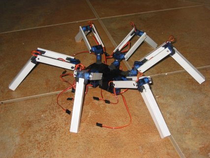

Please keep us updated as you get into this project, especially with photos. The honest reality is I'm not going to touch the Servo library based only on an ambitious plan.... but when you're actually building this project, if you really do connect 20-some servo motors and post good photos, code, measurement and other info, I'll work on the Servo library for you.

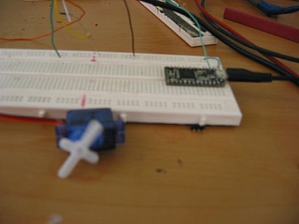

The big question, which you can answer (and I really hope you will) is whether your servo motors work with an 18.1 Hz update rate? Just edit Servo.h to increase to 23 instead of 12. Then write a little test program, or modify the Servo library sweep example, so it creates 23 instances and sets all the unused ones to the max angle. If your motor works and is responsive, then you're good to go!
I mentioned some ideas earlier. Now I want to be clear, I am indeed willing to rewrite the Servo library on Teensy3. I wrote the version that currently works on Teensy3, patterned after Michael Margolis's design. But other than this long-winded message, I'm really going to be looking for you to get involved before I put in a lot of work. I really hope you do. This first simple test with 23 signals, 1 motor connected, and maybe a multimeter to check the frequency, and most definitely a photo, would be a very good first step.

Teensy3 has a tremendous amount of potential to make huge animatronic servo motor projects possible. But it's not the raw CPU speed that truly matters. Careful use of timers and interrupts are the key.... stuff the Servo library does for you. If the current library isn't capable of really supporting a large number of motors, I really would like to work to improve it. But that can only happen if you participate with good updates and info. How much I work on Servo, for the sake of your project, will really depend on how well you post updates and share good info. If you post photos, code, and measurements as you go (without lots of back and forth trying to get the info posted), that will help immensely.
