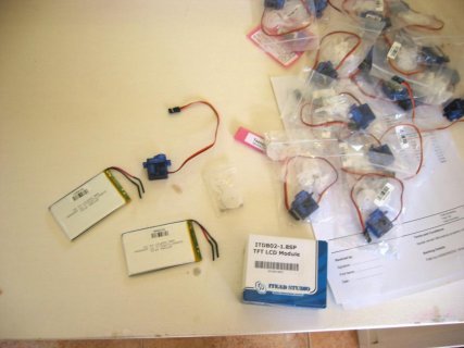

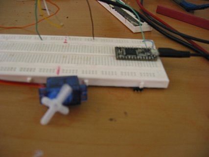

Recently bought teensy 3.0 how many servo's can she drive?
Great news.
The teensy is driving the servo with no issue's.
No TTL tricks required.
"Excited"

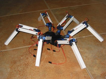

Then I need to look into interfacing the following
X2 Teensy 3.0 boards "to operate sensors and servos"
And 2 to 3 USB cams for 3D Depth tracking. "To help the little bot see "
Nested interrupt priority.
I have no idea.
I looked at servo lib... but not sure.
I haven't programmed a micro controller since the pic16F84 as well but, I learn languages fast.
Just not sure what to be looking for or to modify to drive more servo's.
I have 4 months to finish this project.
I will be graded on it and it will suggest if i shall pass or fail my practical school exam.
So far the competition is far asleep compared to what I am bringing to the party.
There's a job up for grabs and I want to make sure I cement my chances.
Please guys wont you help a dude out.

Ahh.. sorry I kept opening servo.ccp
My bad, thanks.
Will remember to read more carefully.
I'm only human we are all prone to mistakes.. this is why machines would wreck us at war.
#define SERVOS_PER_TIMER 24 // the maximum number of servos controlled by one timer changed to 24 ... idk if thats right..
#define MAX_SERVOS (_Nbr_16timers * SERVOS_PER_TIMER)
//i have no idea what this line does but it seems that it multiplies the amount of servo's per timer by the amount of available timers.... i think..
I also noticed these.
#define MIN_PULSE_WIDTH 544 // the shortest pulse sent to a servo
#define MAX_PULSE_WIDTH 2400 // the longest pulse sent to a servo
#define DEFAULT_PULSE_WIDTH 1500 // default pulse width when servo is attached
#define REFRESH_INTERVAL 20000 // minumim time to refresh servos in microseconds
handy...
Well I can't be 100% sure.
but looks like 24 servo's are sweeping backward and forward.
:edit
Nope only 16 of e'm.
So max = 16 servo's per timer.
How would i fix this...
"how i tested"
Created 24 servo objects
Used 1 servo to test each pin assigned 0 to 23.
servo sweeps on pin 0 to 15 = 16 pins
17 to 23 were not outputting.

Ok i tried that pins 0 to 15 work
17 to 23 are not sweeping.
Servo's are now painfully slow and so is teensy.

Right now the teensy can only drive 16 servo's.
So i figure i am better off driving 16 per teensy.
So 12 servo's on one teensy.
Then 12 to 14 on the other.
This also saves speed and effort and making wring less of a task. :)
