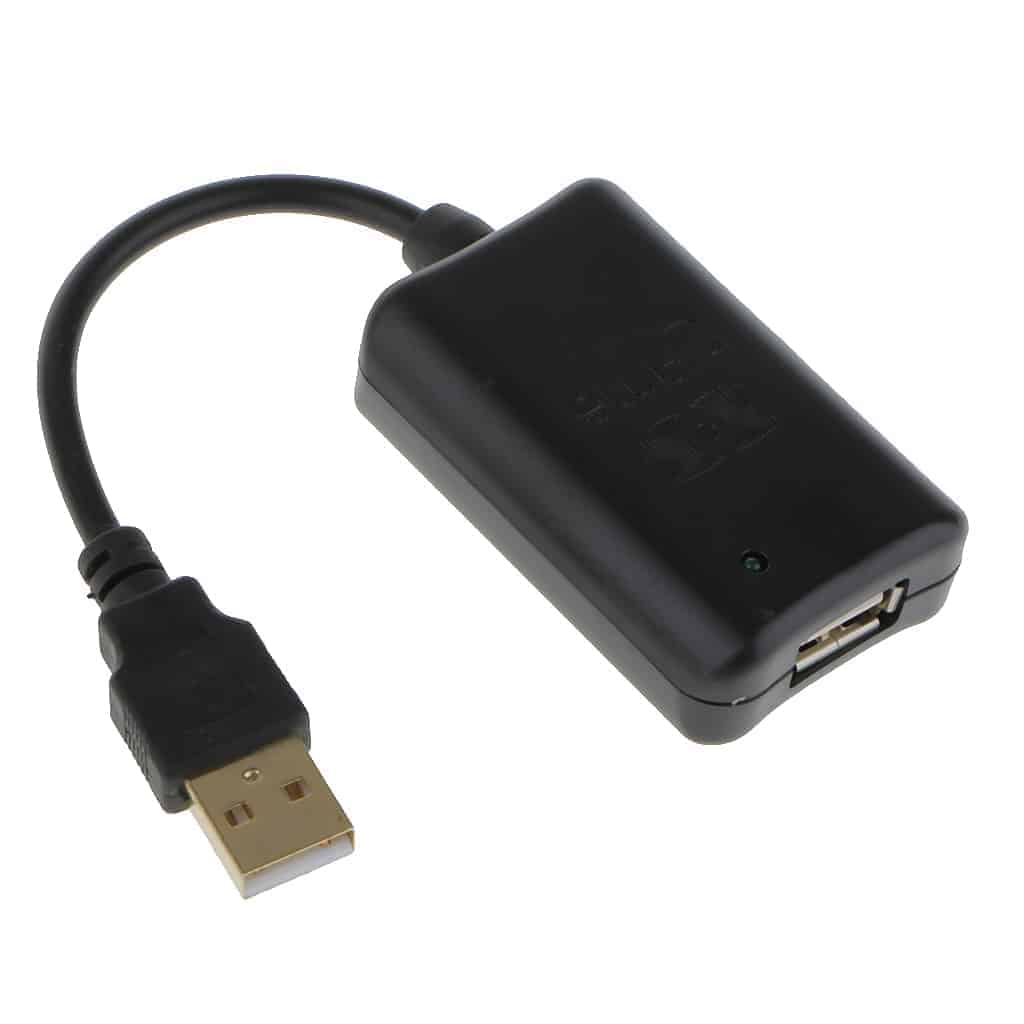

I am working on a project that is causing high frequency noise (sounds like coil whine?) on my studio monitors when my Teensy 4.1 is connected to any USB port.
The Teensy is sitting in a metal enclosure inside my acoustic guitar surrounded by a magnetic guitar pickup and lots of cables which I would like to blame for the source of noise, however the noise even occurs when the Teensy is powered off. The moment the USB cable is connected to the Teensy and PC the noise occurs.
I purchased a Topping HS02 USB Isolator to tackle the noise problem and cannot make it work. The HS02 works with other devices I have lying around (such as an AKAI midi controller for example) but not with the Teensy, neither in Serial mode nor in Serial+MIDI nor in MIDI. The Teensy is neither recognized by the Arduino IDE nor my DAW Reaper. I have tried to force the Teensy to run at full speed USB (12Mbit/s) without success (as suggested here https://forum.pjrc.com/index.php?th...tion-for-teensy-4-0-vs-t3-6.71267/post-314140). Additionally I have tried what was suggested here: https://forum.pjrc.com/index.php?threads/serial-midi-over-long-distance.70173/post-305543 .
(Just to note that the Teensy works perfectly fine when connected directly to the PC without the HS02 in between)
My project is depending on being low latency so I am not sure if there is any advantage/disadvantage to running at full speed or high speed USB when it comes to USB MIDI transmission. Hence my question: Can anyone recommend a working USB Isolator that plays well with Teensy 4.1 USB MIDI at High Speed USB (480Mbit/s) ?
And in case high speed USB is not necessary for my use-case I should be fine going with any "cheap" ADUM3160 as Paul suggests in this post https://forum.pjrc.com/index.php?th...the-lpuart-to-load-the-code.71472/post-315655 , right?
Or would it be more clever to invest into a USB Isolator that makes use of a newer ADUM chip (that potentially also support high speed USB) ?
/Edit: Or should I / do I need to go for a high-end industrial grade usb isolator such as the intona USB 2.0 Hi-Speed Isolator 7054-X-DK ?
I'm happy for any input you might have and thank you for reading,
Heiko
