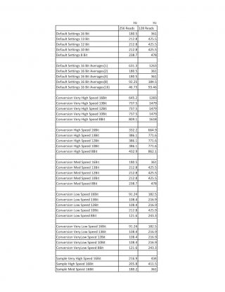

I am trying to sample 4 to 8 Analog input signals coming from microphones on the Teensy 3.1 simultaneously.
Unfortunately there are only two ADC's available on the Teensy 3.1. So to measure 4-8 signals I want to sequentially measure all the target pins and then start again with the first pin. To achieve high sample rates I use DMA channels to lighten the load of the CPU.
The first DMA channel is configured to copy the measured samples from the ADC's output register to a buffer. I tested a sketch in which I only sampled one signal and It seemed to work.
To measure multiple channels I added a second DMA channel. The second DMA channel is configured to rewrite the ADC's configuration register with different values each time the first DMA channel is activated. The target pin numbers are kept in static array and the second DMA channel is supposed to copy the pin number to the ADC's register and thereby switching to a different target pin and starting a new configuration.
Unfortunately this does not seem to work. Any idea what I am doing wrong here?
