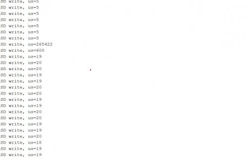

I'm testing the ability of the Teensy (3.2 with Audio Board and 3.5) to record two channels of audio to the SD card and get write interruptions in the recorded stream. Mono works fine. Any hints on how to do this are welcome.
I'm writing tow files concurrently to the SD card, each using its own queue object from the teensy Audio Library.
The occasional write timing increases can be seen in this sample print output.
SD write L, us=1260
SD write R, us=1249
SD write L, us=1268
SD write R, us=1263
SD write R, us=20907
SD write L, us=91518
SD write R, us=89989
SD write L, us=91151
SD write R, us=89601
Below is my test code FYI.
SD write L, us=1260
