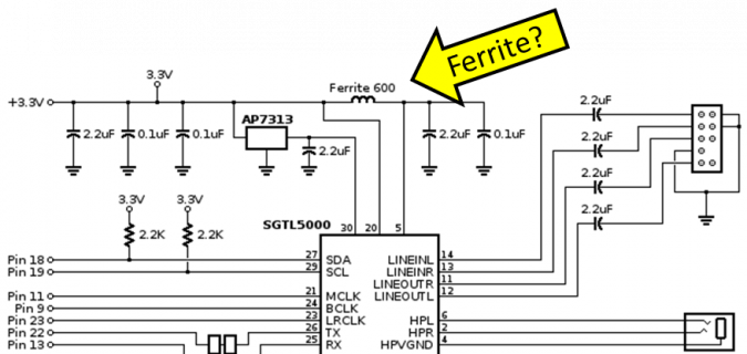

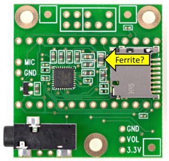

I've been fighting noise issues with the Line-In on the Teensy Audio Board. It's a pretty persistent pulsing hashy kind of noise that my intuition says is related to digital activity on the board. So, I'm looking to see if I can trouble-shoot the issue by looking to better isolate the analog section of the Teensy Audio Board from the digital section.
Looking at the schematic, I see that there is a ferrite separating the analog supply pin from the digital supplies.
I'm thinking about removing that ferrite and inserting a low-noise LDO to be (possibly) better isolation for the analog supply. Since there is no PCB layout published for the Audio Board, it's not obvious to me which component is the ferrite. Can anyone help me interpret the layout. Which component is the ferrite?
Thanks,
Chip

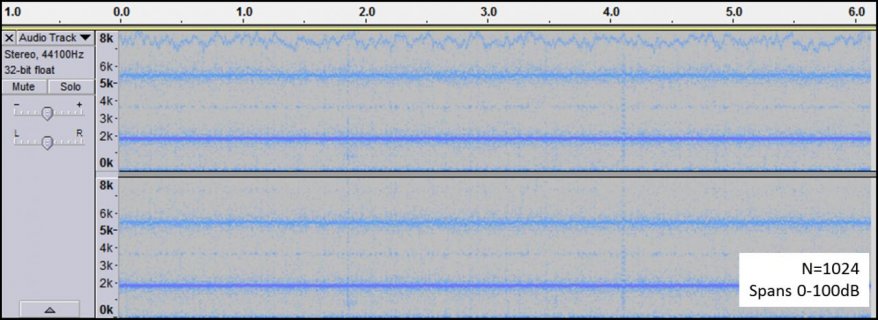

I did a test using LineIn as my input (using the default LineIn gain command of 5) and I set the headphone volume to be 0.5. Attached to my LineIn are are two electret mics from Adafruit (SPW 2430), though it makes the same noise if I replace the microphones with 1 kHz resistors.
I recorded the audio over USB into Audacity via the Teensy's USB Audio Output feature, as I found that the noise sounds similarly through the headphones or via USB into the computer.
During this recording, my laptop was unplugged from the wall outlet, but that makes no difference. Also, I've run the Teensy off battery (to my headphones) and it makes this same noise.
Below is the spectrogram. It shows strong lines at ~2 kHz and ~5.5 kHz. They're strong but fuzzy, which reflects that they don't sound stationary. There's also some lower frequency garbage that is apparent when you make it louder, though this low-freuqency stuff is not nearly as annoying as the high-frequency stuff.
Below is the average spectrum for the whole recording. I don't like how Audacity auto-ranges the vertical axis, but you can clearly see that the ~2kHz tone (actually 1.8 kHz) is about 59 dB down from "full scale", which is quite noticeable. If you want to apply any additional gain (for super-hearing!) this tone gets louder and quickly becomes unbearably annoying.
Any thoughts would be greatly appreciated. As I said, I've tried running off battery and I've tried replacing my mics with equivalent (short leaded) resistors. No help. Any other thoughts?

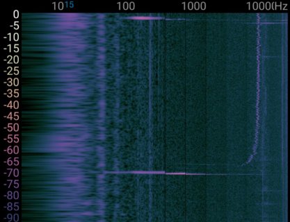

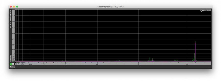

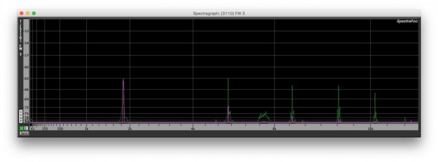

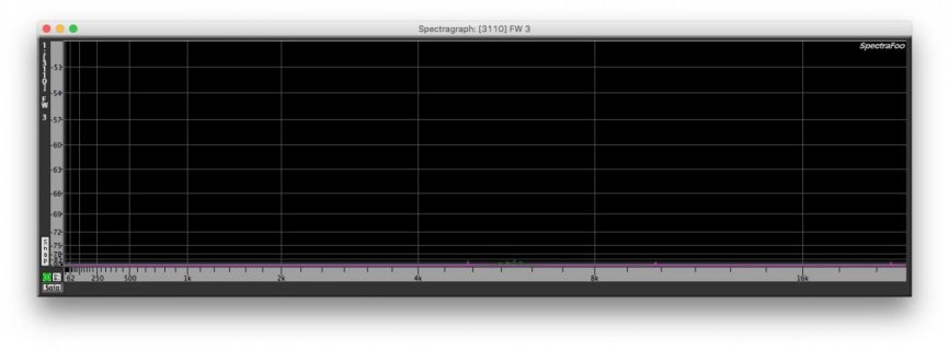

Firstly, the short story is that I have essentially the same issue (see attached T36_Shield2_Silence_4096pt_180M_QbasedPThru).
I have my analyzer set at 4096 points so I see a bit more detail, but you can see they are saying the same thing. I've set its parameters so it matches your grid and scaling etc.
The pink line shows a smoothed average, green shows the peak level.
My testing so far with the 3.6 has been with the noisy FFRT/IIFT setup so I haven't noticed before. Also, when there's a strong signal happening (e.g. a 5kHz sine wave), the level of the noise seems to drop significantly which masks the issue quite a bit.
Not sure why. See T36_Shield2_1kHsine_4096pt_180M_QbasedPThru and T36_Shield2_5kHsine_4096pt_180M_QbasedPThru
Second thing is that my Teensy 3.2 and its Audio shield do not show this problem at all. (see attached image with Teensy32_shield2). There is still noise of course below the -90db level, but the analyzer display settings are excluding these. See T32_Shield1_Silence_4096pt_180M_QbasedPThru
To make sure, I swapped over the audio shields between the two Teensies (I have them attached to the Teensies via un-pluggable female risers). The problem stayed with the Teensy 3.6
The wiring to the breadboard also goes with the shield as they are soldered in to line-in, out, ground etc on the shield).
I seem to have a slightly lower level of noise with my system, even accounting for the fact that I leave about 3db headroom on full scale signals on input. The levels do vary over a period of time though.
Overall, a rise of the effective noise floor from around -86db to -66db or more is not at all good.
All the tests above were performed using a simple sketch that passes though audio based on copying samples from an input queue Library object to and output queue object.
I tried reducing the clock speed so I could try with the standard StereoPassThrough sketch, with interesting results.
For example at 72Mhz there is a very similar noise peak, but at about 17kHz rather than 1.8kHz.
The 'queue' based passthrough sketch with this clock speed still showed the noise at around 1.8kHz, but the (green) peak levels at the higher frequencies had grown quite a lot. (see attached T36_Shield2_Silence_4096pt_72MHz_StereoPThru and T36_Shield2_Silence_4096pt_72MHz_QbasedPThru).

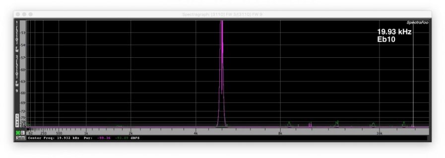

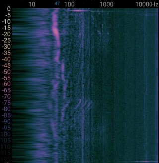

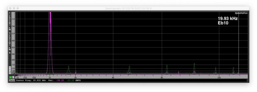

So, I was chasing down an issue where I hear a quickly varying tone around 9kHz when doing filtered pass-through on a quad-i2s setup, per the sparkfun hardware guide. I'm doing a simple crossover with a quad-i2s setup. Stereo in on channels 2,3, and bass-out on channels 0,1, high-freq out on channels 2,3. When changing the crossover filters to just pass-through, I clearly hear the quickly varying 9kHz tone on the "left" channel of both boards. When I specify the MCU frequency to be 96 MHz, the 9kHz oscillation completely goes away. I still hear a bit of broadband-noise, but not a tone.
I'm posting this because changing from the default MCU frequency to 96MHz, per Paul's suggestion, helped get rid of a 9kHz noise for me. For more context, this 9kHz noise is only present when the DAC volume is high. I observe this varying 9kHz tone when the dac volume is -1 dB or I'm setting the DAC volume pretty high at -1.0 dB or 0.89. While the clock is still 72 MHz, and I change the DAC gain from -1.0 dB to -6.0 dB (or 0.5), the varying 9kHz tone is at a much lower volume and instead of changing quickly, it changes slowly. When I say "changes slowly", I mean it's a seemingly constant frequency for 5-8 seconds, then changes to a new value for 5-8 seconds, and so on.

Hi Chip, The part your arrow points to is indeed the ferrite. I did exactly what you are describing and it dramatically reduced the noise! I built a linear supply and connected it across the VDDA cap just to the left of the ferrite in your picture. I also built a 5V linear supply to power the Teensy. There's a picture and more information in my thread, "Bass Preamp Project" down the screen somewhere :)
On a related note, I was trying to use A8 as a pot input, but found that the noise from BCLK and MCLK were inducing a lot of noise on that input. Not surprising because A8 (pin 22) is right between those two signals! I confirmed that if I disabled the Audio Shield, the noise on A8 disappeared.
