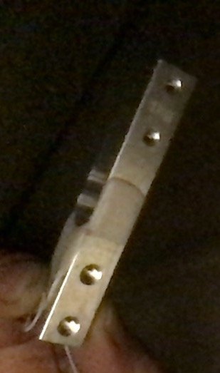

Another approach to measure wind speed would be to use strain gauges, but I haven't seen any implementation of the concept.
The tricky part here is probably that both material stiffness and (IIUC) the Wheatstone bridge circuit used to measure the deformation are temperature sensitive. So it would ideally require extensive calibration, or at least a good model of the influence of temperature on these two parameters.
Also, I'm not quite sure yet of how to mount the whole thing. I suppose I could use two flat pieces of metal, placed orthogonally. For each plate, put a strain sensor on each face and get the resistance difference using the Wheatstone bridge.
Alternatively, I suppose I could use a single spherical rod with a hollow sphere at the top, and put matching sensors on the shaft, perpendicularly... Perfect sensor placement would probably be pretty hard to achieve, but I could correct it in software.
Edit: Now that I think of it, this would probably entail having a fairly rigid mounting system...

Back in the 1970s I built a wind speed and direction sensor using a rod of phosphor bronze and two strain gauges. It worked well. We were building a robotic sailboat which had the wind sensor at the top of the mast, so it had to be ultra reliable and rugged. It's pretty simple if the rod is fixed in an upright position. In our case we also had to compensate for heeling of the boat.

I bought them pre-glued, they look like this (not sure how they're supposed to look or if it was a good job):
