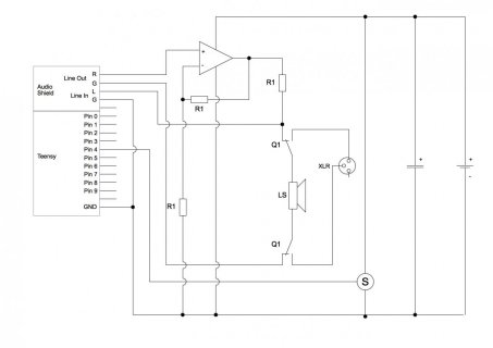

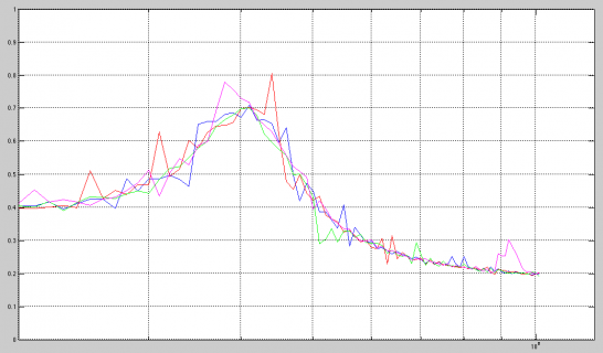

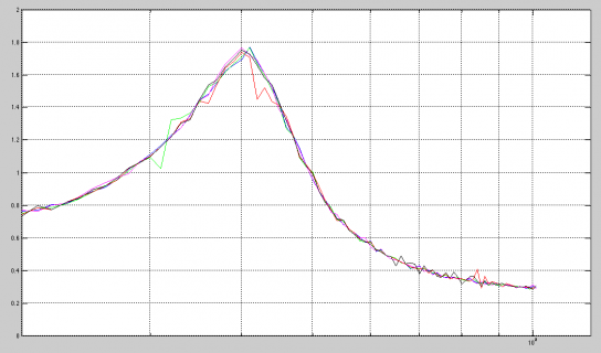

I'm trying to measure the impedance of a loudspeaker. The resonant frequency where the impedance has its maximum should be at about 60Hz.
So I programmed a sine sweep from 20 to 120Hz and send it through a resistor in series to the loudspeaker. Between them I am trying to measure the av voltage with analogread() but it doesn't work. Is there an other way to measure it? I Think the problem is, that a measure at a very short time the DC voltage....
