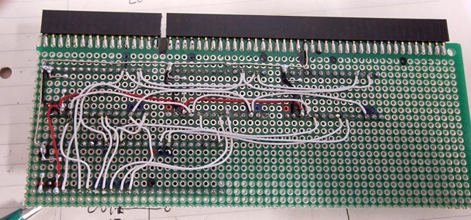

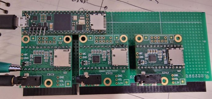

I've got 3 boards wired up on each I2c output using the modified audio library that can address wire, wire1 etc and although everything compiled when I'm using the test code created by Paul recently no waveforms are generated. I guess I should just try and get sound out of one card first.
Hi Paul
Yes, that's the code I'm using with changes to the setaddress line to setwire, but even without the changes I would have expected card 1 to work.

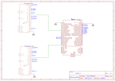

Also I tried an I2c scanner sketch and it couldn't find any cards which I thought was a bit strange. I will make a schematic and post it up shortly.
I hope this is viewable, although I have 3 cards attached, I've only shown 3

I can see a clock on the MCLK line, more of a sinewave but symmetrical in appearance.
I have loaded another test sketch which plays a sinewave with alternating frequencies and this works on sound card 1, so I'm confident in my wiring.

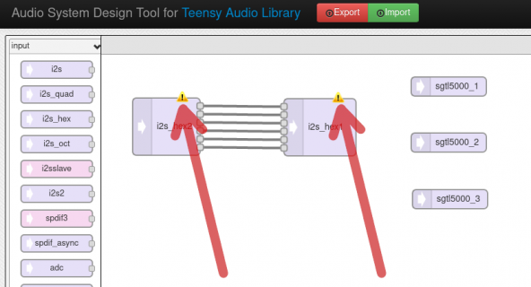

I can't 100% see your wiring, but it looks as if you only have one I²S input wired; if I'm reading the library code right, your second audio adaptor needs its DOUT / pin 13 wired to the T4.1 pin 6, which can function as either OUT1D or (presumably) IN1B.
Secondly, I2S1 has 5 data pins, each supporting 2-channel audio, but you have to have at least one configured as output and one as input. Hence you can't use an AudioInputI2SHex and an AudioOutputI2SHex together - one has to be Quad. They'll clash (I think) over the use of T4.1 pin 9, and probably do neither function! The audio system design tool puts a warning triangle on the two I2SHex objects when I import your design from post #17, for that very reason...
Spent a few minutes looking over the wiring. MCLK, BCLK, LRCLK looks good. I2C looks probably ok too. Looks like the DIN connections are good too, going to pin 7 (OUT1A), pin 32 (OUT1B) and pin 8 (OUT1C).
Yes, I believe that is probably the cause of the problem.
I imported the audio instances from msg #17 back in the design tool, and sure enough it shows the warning that they can't work together.
