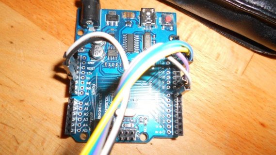

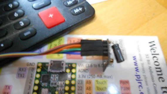

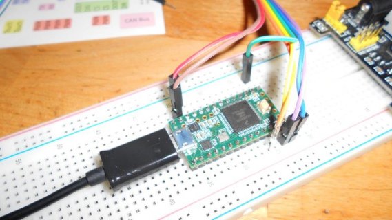

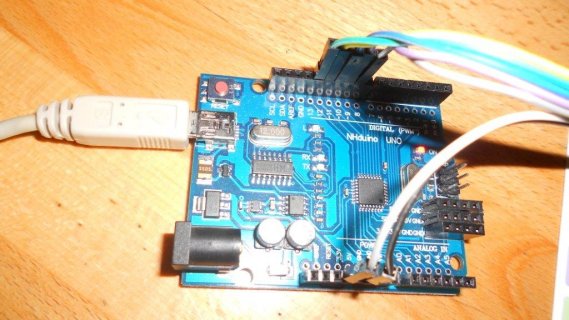

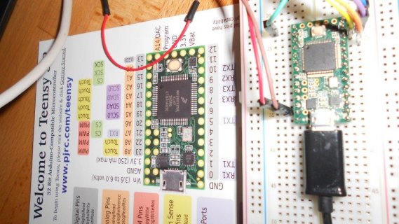

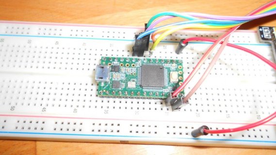

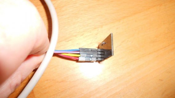

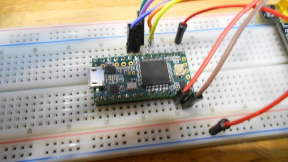

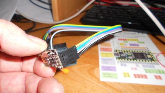

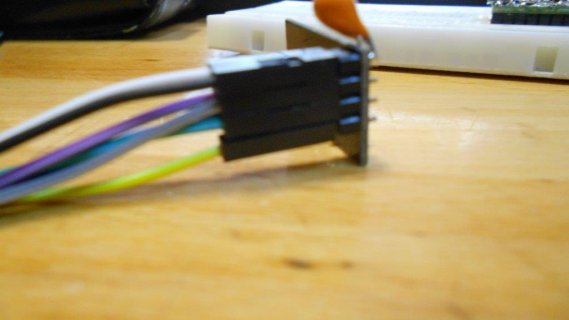

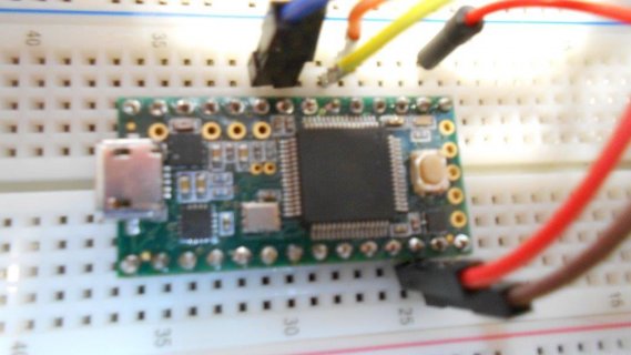

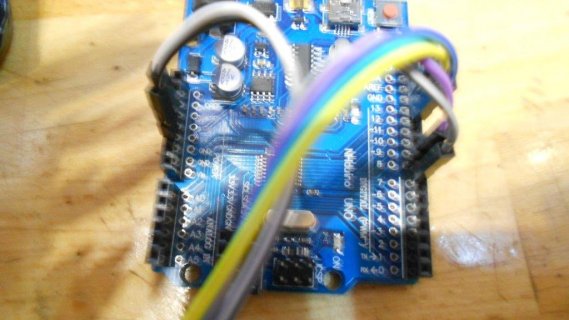

OK I now have a red face but what the heck,
I am sort of getting info now but have also had to adjust the sketches. Before I explain everything I will include the code agin, the wiring and the Monitor info.
Here goes,

Teensy Mon.
Now sending
failed
Sent 159481763, Got response 255948888, Round-trip delay 231826 microseconds
Now sending
failed
Sent 160714233, Got response 257181400, Round-trip delay 231825 microseconds
Now sending
failed
Sent 161946696, Got response 258413920, Round-trip delay 231870 microseconds
Now sending
failed
Sent 163179209, Got response 259646432, Round-trip delay 231824 microseconds
Now sending
failed
Sent 164411671, Got response 260878952, Round-trip delay 231822 microseconds
Now sending
failed
Sent 165644138, Got response 262111472, Ro
UNO Mon.
failed
Failed, response timed out.
Now sending
failed
Now sending
failed
Now sending
failed
Now sending
failed
Now sending
failed
