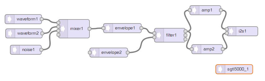

Hi folks
Just got my first Teensy (4.1, start at the top, right?) and dead excited about the audio possibilities. I've toyed with the Nord Modular kit in the past, and this looks very like it in concept, but so far without the (semi-) live editing and patch saving capabilities. One fundamental limitation seems to be the fact that all AudioStream and AudioConnection instances are currently constrained to be statically allocated, though at least it appears the connections can be re-patched on the fly.
Before I jump in with both feet and try to get these a bit more dynamic, (a) have I failed to spot a reason why it can never be done, and (b) is anyone else already working on this? I've scanned this forum and couldn't immediately spot anything, but I guess it'd be easy to miss with the number of posts there are here. I'm hoping (a) isn't the case - the section at https://www.pjrc.com/teensy/td_libs_AudioRoadmap.html relating to this suggests that there's some chance...
Cheers

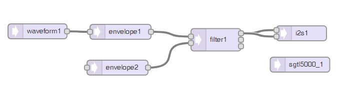

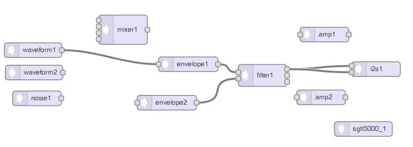

Thanks manicksan. This would let one switch the connections on the fly (at the cost of considerable complexity!), but as far as I can tell the AudioConnections can be changed anyway, though of course at the cost of potential glitches. They can also be created and destroyed, as they appear to have a proper constructor and destructor. The same isn't true of the AudioStream class, as it doesn't have a destructor, so you can't go from:
to
without re-compiling the code, though I think you can go to:
with the "orphaned" blocks consuming little to no CPU, and without having to re-compile.
This would be a first step on the road to being able to make edits in the Audio System Design Tool and auditioning them live in real time, saving patches to SD card and recall them on the fly, and other neat things.
Cheers
Jonathan
