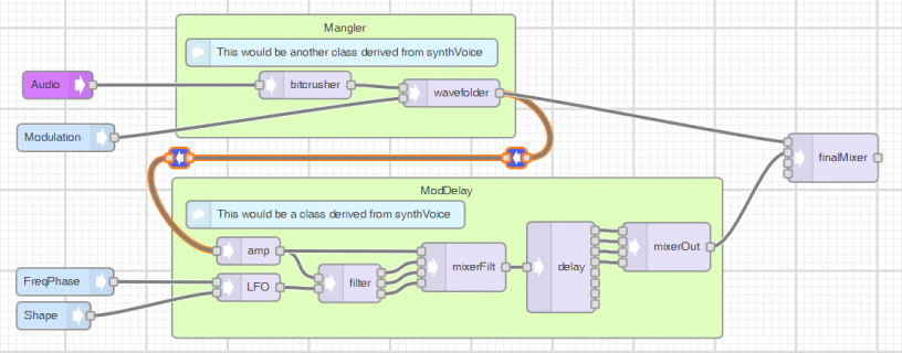

Hello h4yn0nnym0u5e, I'm lookin' for some help again.
I'm successfully using your library to create and delete synthesis objects. I've copied what you did in PlaySynthDynamic.ino and voice.h which is used by that example.

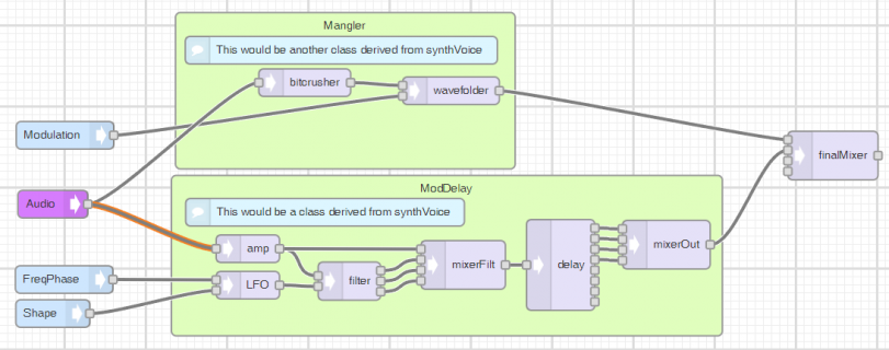

Now I'm trying to do the same with effects. Basically have a duplicate effects.h like your voice.h. The problem I'm running into is effects have inputs to the audio objects, not just outputs. In your example you connect synthesis objects as follows:
That does not have an option to connect an input and effects need input connections. I tried to rewrite the code you have in voice.h to have it accept an input using my connect2 function but I can't get it to work.
Can you point me in the right direction?
My effects.h, which does not work, is below. (I did temporarily put a wave generator within the effects.h to make sure that the class works if I'm not trying to use an input, and it does.)
waves[chan]->connect(mixArray[chan&3],chan>>2)?"nope ":"");
