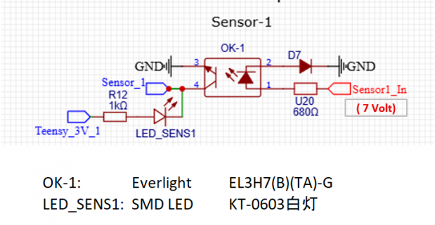

Hi to all,
I have made and engine RPM sensor with Teensy 4.1 board. It is reading alternators rpm and write it to Dwin HMI. I have used LJ12A3-4-z/AY PNP inductive sensor. It trigers once per revolotion. My problem is this : It reads normally until the 3600 rpm. But it can not read more than this value although it has 500 Hz switching capacity. (it should read 30.000 PRM for 1 trigger per revolotion) What can be the problem? Could you investigate my code and circuit below please?

Circuit: Attached.

Thank you very much for your suggestion @kd5rxt-mark. Acctually there are diffrent functions in my code like DC servo control, data reading & writing to Dwin HMI via UART, Can-Bus control, some button control etc. It is multi tasking code. Main aim of threads is preventing function interrupts. Because when i tried to code it without threads, i can not read datas thats sending from HMI because of high frequency interrupts of RPM sensor. So i have added thredas. Code is a little bit long. So i did not share all of it. I have shared only problematic part. Other parts are OK.
I can remove 10 ms delay. No problem. But as well as i understand, circuit can be problematic. Do you have any comment about it?

You could temporarily short out LED_SENS1. Teensy port pin was not initialized in setup to have a pullup. If this makes code work, then you can add a pullup resistor external to Teensy, or init port pin with pullup. An open-collector circuit needs a good pullup resistor.
Thank you @BillFM . Sorry, i skipped to copy that part while extracting RPM sensor codes. Actually, it has been initialized at setup as:
pinMode(sensorPin, INPUT_PULLUP);
attachInterrupt(digitalPinToInterrupt(sensorPin), pulseISR, FALLING);
Ok. Let me short out LED_SENS1 and try. Can it be acceptable to add soft pullup for Teensy input?

Yes you are right. I tought this but I have tried diferent simple RPM counter codes also. Result was same. It could read up to 3600 rpm. So I understood that the problem was related with hardware. To make the analysis easy, and prevent confusion, I extracted RPM codes from all code and write to here. No problem, if you still think that it will be useful, I can share it in a file.
Hello.
Since the opto is currently detecting signals up to 3600rpm (60Hz), and 60Hz is a pretty slow frequency, and the internal Teensy pull-up is enabled, this suggests the internal pull-up is not sufficient to do the job (above 3600rpm). Hence my suggestion to short out LED and let existing 1k Ohm (R12) resistor act as the pull-up to see what happens.
There could be other factors at play here. I've not looked at opto datasheet and we don't know anything about the 7V signal source. Could be that opto LED is not driven hard enough to have a decent energy transfer to the photo-transistor. If that's the case, photo-transistor might not be turning fully ON and can't sink very much current. i.e., not reaching logic 0 voltage level.
When you say it doesn't work above 3600rpm, what do you observe?
No rpm changes reported?
Erratic rpm changes?
Incorrect rpm reported?
Have you gotten another Teensy or other MCU. If so program it to output 70Hz. Disconnect your RPM sensor and feed the MCU/Teensy pulses into your sensor/RPM measuring Teensy. If you see 4200RPM then your code is working ok. You could alter the rate of pulsing to determine the actual MAX Rpm that the Teensy/software can support.

Hello @BillFM. Ok, I will try it with shorted out led and mention about result. I am also suspicious from the that led also.
I have also tried the +12V signal source for opto. It was more problematic than 7V source. Because when i aplied 7V, it was measuring up to 3600 rpm and staying at this value. But when i aplied 12V it was measuring until 3600 rpm normally. After this value it was showing abnormal values like 0, -250,5000 etc. So i cancelled +12V feeding to sensor.

Thank you for your suggestions @KrisKasprzak. I have tried some methods to understand the problem yesterday. As @BriComp s suggestion, I have connected an arduino board's output pin to my RPM sensor input pin and coded the arduino as 150 Hz ( 9000 RPM) output frequency. I could see this value with small diffrence (8940 rpm). So i suppose my problem is related with sensor. It's switching frequency is not enough although it seems enough in product manual theoretically.
I have searched about cars RPM sensor. They are magnetic hall effect sensor. So I am searching about suitable hall effect and high switching frequency inductive sensor. I am not sure which one is OK. Hall effect magnetic sensor is good option but I can not fix a magnet on alternator. There is not any place. If i stamp a magnet on alternator wing , it can cause balance problem even if it is small and it can fall down after for a while. So i am searching about high quality inductive sensors which can catch max 10000 rpm.
If you can share your sensor schematic and frequency measuring code, i would be glad. Your experince is very important for me.
I can not connect sensor input to pin 23 because of PCB design. It is very hard to change it now. But for next project, i will design it as your suggestion. But what is the diffrence of those pins? pin 23 is PWM pin. Do you mean about it? Does it cause any trouble to connect it to an analog pins?
