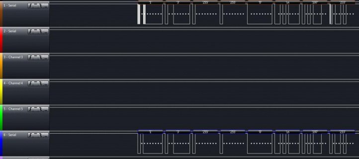

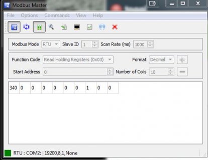

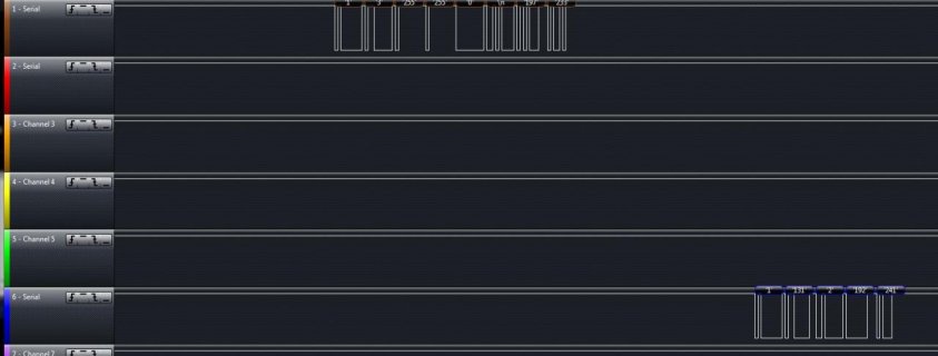

So I am having some crazy difficulty with this... I am ending up talking to a modbus device that uses RS232 (still modbus RTU not ASCII) instead of 485, so I ditched my max485 chip and plugged straight in. I get the same reply from the device no matter what I do:
read returned: 65280 2757 59760 0 0 0 0 0 0 0
write returned: 0
When I use a modbus test application on my PC it comes back with the correct numbers (a 345 in the 1st register and a 1 in the 7th register)
I'm really confused what is going on and would love any suggestions.
Thanks!

My logic analyzer is seeing this:
Please ignore the attached thumbnail, I don't see a way to remove it. Just use the inline image here
Lord almighty...
this line:
 * start_addr: address of the slave's first register (+1)
means "you need to add one yourself" I guess... so I just changed to
retval = read_holding_registers(1,1,10,data,10);
and amazingly... it works perfectly now!!
