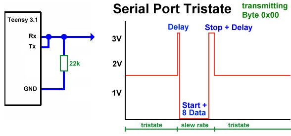

How do you check that tristate is working correctly ?
Obvioulsy you need an oscilloscope to check that.
Then you connect a 22k resistor from Tx to ground.
The internal pull up resistor in the CPU is also 22k Ohm.
So in tristate mode the TX pin will be at approx 3.3V / 2 = 1.7 V.
With this code:
you will see on the oscilloscope:
As you see there is a short delay between switching to normal mode and the Start bit
and another delay between the stop bit and switching back to tristate mode.
This delay is about 2 µs on Teensy 3.1 running at a CPU clock of 96 MHz.
During this delay the TX line is HIGH.

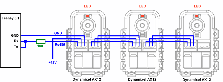

And how do you connect the Dynamixel ?
The Dynamixel should be connected via a 100 Ohm resistor as a protection.
In case that both (Teensy and Dynamixel) send at the same time it protects the output pins.
But this will only happen if there is something wrong in your sketch.
Normally it will never happen that both send at the same time.
Apart from that normally the CPU pins survive shortcuts for a short time.
With this code:
byte data[] = { 0x00 };
Dynamixel_Serial1_Write(data, 1);
delay(1);
________________________________________
