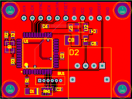

I'm currently working on a micro audio solution with Teensy 3.1 + Audio Adaptor Board and the Adafruit 20W Class D Amp.
Unfortunatly there is no S/PDIF input, so i decided to design a breakout-board to close this gap.
I'm using a Xilinx CPLD XC9572XL-5 running on 66MHz for flexibility and better core development in the future.
So for now, here the schematic and first version of the PCB:
S/PDIF Input, I2S Output
Dimensions: 30x40mm
