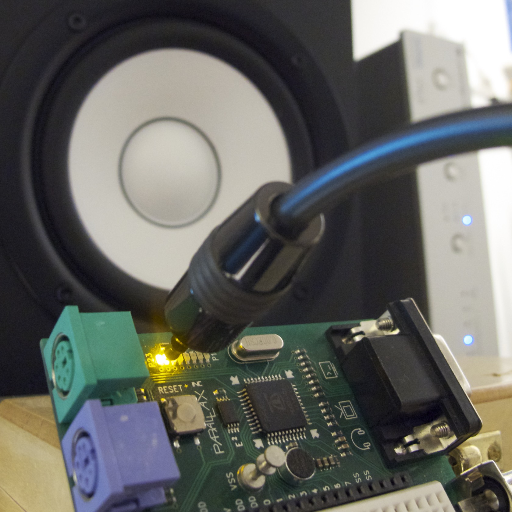

EDIT:
Working version: https://github.com/FrankBoesing/Teensy3-SPDIF
Only PIN22 is needed.
Today I read me a bit in S / PDIF.
I think we could make it happen on a Teensy using SPI.
The protocol is not too complicated, actually we could even use the 2 SPI device of T3.1, because there is no need for SCK.
Unfortunately there is a problem: The baud rate.
We need exactly 64 * 44100 Hz (= 2.8224 MHz)
I do not believe that the SPI device this baud rate can generate, but maybe there is a trick?
What comes to mind:
- An external clock with the SPI device in slave mode (perhaps with a tiny avr which generates the clk?)
- Somehow use the built-in timer to generate (2x ?) 2.8224 MHz
Unfortunately, we can then no longer use SPI for other things, such as rading from SD.
Another idea: a Teensy LC as a "slave" for the T3.1. The LC would do S / PDIF output (again we have to think about the clock), the T3.1 provide the audio data to the LC.
What do you think?
Do you have any other ideas?
