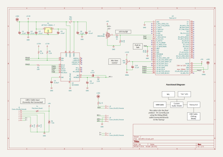

Objective 2: Due to space constraints, I could not fit the stock Audio Shield without chopping it up. Cue me designing a custom shield.
- For some reason I thought using the QFN20 version of the SGTL5000 chip was the best option. I based the electrical circuit based on the PJRC documentation. Since many features weren't needed for my application (SD card, line out, line in, headphone) I did not include them.
- Attached to this post is my electrical circuit with some annotations that may help explain what's going on. The SGTL5000 section -- I tried to copy the power and mic circuit exactly from here https://www.pjrc.com/store/teensy3_audio.html
- Used the same code from Objective 1.
- I have not been able to get any response with my custom shield.

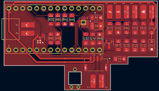

Hmm, just saw the note "Wires for MCLK, BCLK, LRCLK, TX & RX should be kept short. The audio shield is meant to connect to Teensy through short pins. Wires can be used, but wires must be short to avoid problems."
Per the attached PCB layout, is it something I should mostly be ok with?

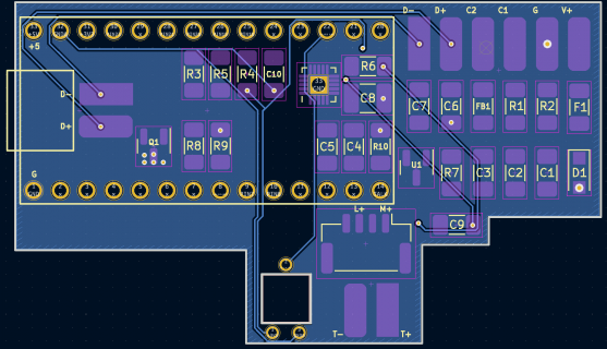

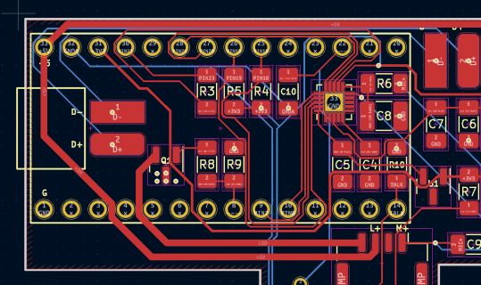

The decoupling caps are rather big and far away from the chip - 0603 is a better choice. traces carrying power and ground should be wider to reduce inductance. It will probably work though, just a bit closer to the edge than is generally liked.
Vias in pads are a bad idea for smaller SMT parts BTW, they can tomb-stone.
A ground-plane on the bottom layer would be good. Then signals get a low-inductance return path and won't ring so much.
Thanks! Is the recommendation to redo the layout with 0603 decoupling caps and move them closer? Before I go that far, is there an equivalent of a *IDN? to see if the SGTL5000 is able to communicate at all?
Noted about the trace widths and pad vias. I tried to shave every 0.010" off any apparently made some non-optimal choices.
For what it's worth -- both the top and bottom layers are both filled GND planes. I hid them in the prior image as they would have drowned out some of the other information. I tried my best to keep data on the bottom layer and power on the top layer.
This is so embarassing... The culprit is... Insufficient soldering at the QFN20! Such a rookie mistake and I can't believe I missed it, even under microscope. I have many things to tidy up but it should be downhill from here! Thank you again PJRC contributors for all the amazing documentation that goes behind the hardware and software!
