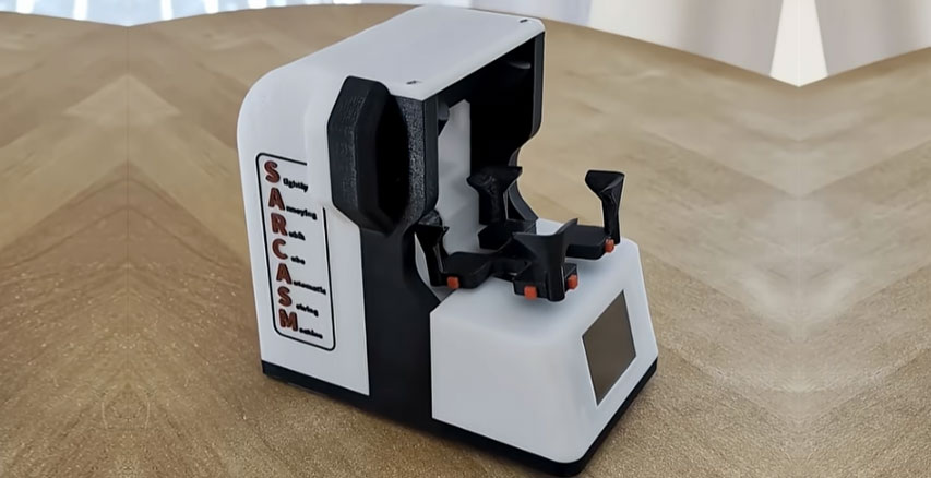

Hi everyone,
Here is a project I have been working on and off since covid, which I finally found some time to complete this summer... So I proudly present:
S.A.R.C.A.S.M : a Slightly Annoying Rubik's Cube Automatic Solving Robot.
Here is a short video in action:
My goal was to create a "desk toy" I can play with when I get bored at work... :cool:
Its main features are:
  1. Compact: it does not take much desk space.
  2. Autonomous: battery powered with USB-C charging port (also used for flashing code), no internet or external computer required.
  3. Near instant power on/off: this ruled out using an rPi Zero for the mainboard...
  4. Compatible with any standard Rubik’s Cubes: no alteration of the cube is required (it works with hard-to-turn cubes, non-standard sticker colors...).
  5. Robust: it can withstand children mishandling the machine (e.g. interfering with the motors, misplacing the cube...) without risk of damage.
  6. Fun, perfectly useless, and completely over-engineered: many unnecessary gimmicks (rgb lights, audio, 3D graphics...). Well, as you can guess from the design, I am a Portal fan.
Below is another (longer) video of the machine showing some of its features.
Currently, there are over 900 dialogs and 100 songs loaded in (thanks to ChatGPT for helping create the dialogs!), so using it still feels fresh every time. I am quite pleased with the result (and my kids love to play with it).
From a technical pov, I think this project really showcases the power of the Teensy 4.1. In particular, here, the T4.1 performs
  • JPEG decoding and color analysis from cube images (taken by an ESPCAM camera).
  • Running the cube-solving algorithm (using my port of Kociemba's algorithm)
  • Driving the display with real-time 2D/3D graphics (using my graphics library TGX and my display driver library ILI9341_T4).
  • Running real-time audio speech synthesis (using my port of the espeak-ng library for T4).
  • Driving the audio chip via I2S (using PJRC's Audio lib).
  • Driving 2x servos and 1x stepper motor using custom drivers with precise real-time feedback monitoring.
  • Driving the RGBW led strip (using the OctoWS2811 library).
On the hardware side, I created a custom PCB and a 3D printed enclosure (it's a tight fit!). On the software side, this means using many peripherals simultaneously: 2× SPI, 2× Serial, 1× I2C, 1× I2S, SDIO, 2× ADCs, many GPIOs... several interrupts/hardware timers/DMA channels, multithreading... and a lot of memory (980KB RAM, 3 MB of EXTRAM, 7.7 MB FLASH and 400 MB on the SD card). I always like to use Teensies for my project but, for once, using a T4.1 does not feel overkill :)
Here are a few more photos from its inside (a bit outdated: cable routing was improved and the usb data line is now properly shielded).
I will try to provide technical details on the build and the code in another post.
I may also make the github repo public at some point but it is currently too messy...
Cheers,
Arvind

Thanks for all the kind words :) Here are some details about the build for those interested. It is a long post, so I am splitting it into two parts: one about the hardware and the other about the software.
Hardware
Enclosure:
It was designed with Fusion360 and 3d-printed on an old Prusa MK3S with white, black, and red PETG (except for the rubber feet which are in TPU). It took a few iterations and a couple of filament spools to get it right. I tried to make the design as compact as possible while still making it easy to insert and remove the cube. One difficulty is that the ESPCam has to be far enough from the cube so that it can still focus and take pictures of a whole face. The tumbling mechanism also requires some space, but fortunately it can share the space already needed for the camera.
Electronics:
  1. Power supply.
  • Everything is powered from 2×18650 Li-ion batteries in series (so the voltage ranges from 6.4V to 8.4V).
  • The batteries are monitored by a 2S BMS and charged through a 1A/2S charger module (DDTCCRU) connected to the USB-C port on the back.
  • Charging is at 1A, so there is no need for a special power delivery scheme. It could go to 2A, but this is already fast enough (the machine works several hours with a single charge).
  • The mainboard PCB also contains 2 independent step-down regulators that convert the battery voltage down to 5V. One of them is used to power the servos and the other one for the rest of the electronics.
  • An INA219 voltage/current sensor (connected via I2C to the T4.1) is used to monitor voltage and current through the USB port. The T4.1 also has an analog pin dedicated to sensing the battery voltage (after a voltage divider and clamping by a Zener diode for safety).
  1. Back panel.
  • A big momentary push-button on the back is used to turn on/off the device. It is connected to a Pololu "mini power switch board" (MOSFET-based) that controls all power going out of the batteries and into the machine.
  • The Pololu switch is also controlled by a GPIO of the T4.1 so that the machine can turn itself completely off via software.
  • The USB-C female port on the back is used both for charging and for flashing with the USB data lines connected to the T4.1.
  1. Stepper motor
  • The "cradle" that holds the cube is rotated by a stepper motor (17HM15-0904S, 400 steps/turn, 0.9 A per coil).
  • The stepper is driven by a low-voltage DRV8834 motor driver controlled by the T4.1.
  • An AS5600 magnetic rotary sensor is fixed on the back side of the stepper motor. It is used to monitor the absolute stepper position and is connected to the T4.1 via I2C.
  1. Servos
  • 2 servos are used: one for the "grip" that holds the top face of the cube and the other to "tumble" the cube.
  • Both servos are identical and of the type "cheap 9G micro servo" but with full metal gears and an additional 4th feedback wire: this is just a wire connected to the internal potentiometer of the servo, so that reading the analog voltage on this line provides an approximate position (but it is a crude and noisy signal).
  • The servos are powered by one of the 5V regulators on the mainboard. Each servo may draw up to 1A (the regulator can provide up to 3A). The regulator for the servo is also controlled by a GPIO on the T4.1 so it can programmatically be turned on/off.
  1. Display.
  • This is just the usual Chinese red-board ILI9341 display in 2.4" format with the XPT2040 touchscreen. It is connected to the T4.1 on SPI1.
  • I created a simple PCB for the display that breaks out an IDC connector so that it can be connected to the mainboard by a flat ribbon cable.
  1. ESPCam/Camera.
  • Image acquisition is done using an ESPCam module (ESP32 + OV2640 camera).
  • The ESPCam is connected to the T4.1 via both Serial and SPI (with the ESP32 as master and the T4.1 as slave).
  • The T4.1 controls the ESPCam power through a high-side MOSFET on the mainboard as well as the reset and boot pins of the ESP32. Thus, the T4.1 has complete control over the ESPCam and can turn the module on/off and reprogram it.
  • I designed a simple PCB for the ESPCam which, again, breaks out an IDC connector so that the ESPCam can be cleanly connected to the mainboard by a ribbon cable.
  1. Lighting
  • 25 LEDs from an SK6812 RGBW LED strip (144 LEDs/m). I chose the SK6812 over the WS2812 because it pulses at a higher frequency (1.2 kHz), which improves camera image consistency.
  • The LED strip is controlled by the T4.1 GPIO via a 5V level shifter (SN74LV1T34) located on the mainboard.
  1. Audio
  • A small 3W/4ohms speaker is located at the front of the machine. It may not be the best-quality speaker, but I do not mind because I am looking for old-school/metallic sounds anyway.
  • The speaker is driven by a MAX98357A I2S audio chip located on the mainboard and connected to the T4.1 via I2S.
Mainboard:
I designed a PCB to connect all the components above together. I am no expert in PCB making, so I went the easy way and used the EasyEDA software to design the board and then used JLCPCB to print it. I used their SMT assembly service to solder the small SMT components, so I just had to solder the PTH ones by hand... Honestly, I am really impressed by the cost/quality ratio offered by these Chinese companies. It may not be suitable for professionals, but for hobbyists such as myself, it is a godsend: I ordered 2 boards with SMT assembly and they worked perfectly out of the box...
I used a 4-layer PCB for the mainboard. I might have gotten away with a 2-layer board, but using 4 layers made things much cleaner and let me create proper ground and power planes. As already mentioned, the board itself contains two 5V/3A step-down regulators based on TI's TPS5430 chip. It was fun to learn how to lay out a step-down circuit. As I am a beginner, I stayed pretty close to the recommended design indicated on the chip's datasheet. The PCB also contains the audio circuit based on the MAX98357A I2S audio chip. Again, I played it safe, and my design is heavily inspired by Adafruit's breakout board for this chip. Finally, the mainboard breaks out all the connectors to the display, ESPCam, servos, holds the Pololu switch module and stepper driver and transistors/MOSFET to power on/off different parts of the circuitry.
Here is a photo of the boards.
