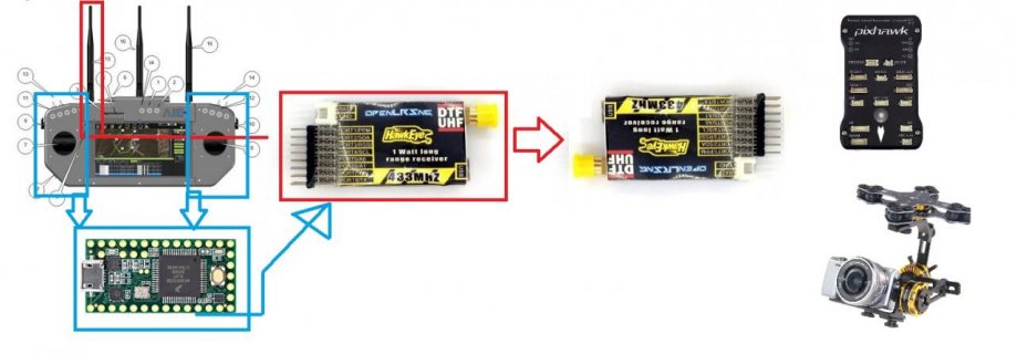

I Have this code working on my teensy3.2, but my analog input does nothing.
When I view the serial monitor I only get these values bouncing back and forth:
Here's my code, I know its not the way Brian (brtaylor) has suggested to use analog inputs to generate the sbus signal (Link here), but I also need to use digital inputs mixed in with my analog inputs, and im not sure how to keep all my channels in order, so im trying it this way.
Please note that the void loop "heartbeat" is just there so I can see that the teensy is actually operating
My end goal is to output 15 sbus channels, made up of 10 analog inputs and 10 digital inputs.
The order of those inputs is not all analog then digital, they are all mixed in together.
Within that 10 digital inputs I have 6 momentary switches that are mapped to a single channel (Channel 5). I want to be able to output a predefined value dependent on which switch is pressed, and maintain that value until another switch is pressed.
Im still a noob at coding anything (as my code shows), but I started this project a long time ago, and decided to pick it back up myself over this holiday period.
There's obviously a number of ways to read the inputs and generate the sbus output, and I'd like to do it the most efficient way so any suggestions will be appreciated.
Here's a pic of what im basically trying to do
