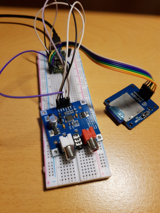

I'm building a SD Card Hifi Audio player to replace my CD player. I already own a SD Card audio player from China, but it doesn't work properly so I decided to build my own.
In this thread I'll try to post my progress.
The first screenshot is the result of my very first test with a Teensy 3.0 connected to a SD card reader, which I bought on AliExpress or eBay. It displays the FLAC files on the card. I used the SDFat Arduino library.

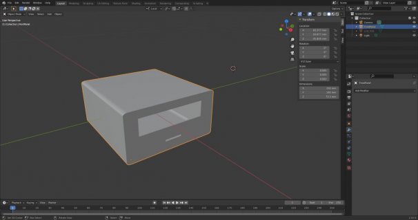

I'm also trying to make a visual representation of what the audio player will look like using Blender. The dimensions are exactly to scale, based on the enclosure and LCD display I purchased from AliExpress.

I've switched to Teensy 3.1 as the Audio Codecs package didn't work with it. I even posted a question about it on Github.
It now compiles without a hitch and I should have it up and running pretty soon.
Stay tuned.
The enclosure I'm using is from AliExpress. The enclosure itself is pretty cheap but the shipping hugely expensive.
I'm using this DAC board with a Burr-Brown PCM5102 D/A converter and an I2S input.
